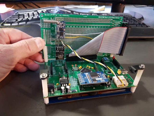

Not much happening with IO on this one;
Just an ESP-01 & a HC-12.
It receives data from all my others.
The size is the biggest issue; not matching the E-100.
Notice the top left hole is slotted to get a screw in &
the lower edge is being grabbed by a couple of bit of plastic.
There's also a fly lead to get the console to the board;
That's no big issue.
The folded 40 pin ribbon is not an issue here; could be in some cases,
but could also be folded against the bottom of the board rather than between the two.
Phil.

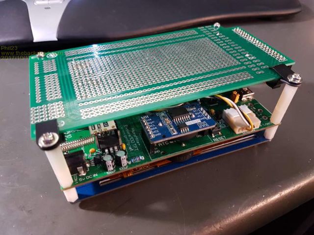

Posts: 10076
Posted: 03:32pm 16 Oct 2017
OH, I see what you mean now.
The prototyping board was never designed to be stacked with the E100, but that is actually a pretty damn good idea now you point it out.
It would be easy enough to change that for the next version though. This would have the effect of making the prototyping board slightly shorter, but slightly taller if you get my drift.
This means you would have to loose a few of the columns of connections, so there might only be 35 columns instead of 40 as there is now. Do you see that as any kind of major problem?

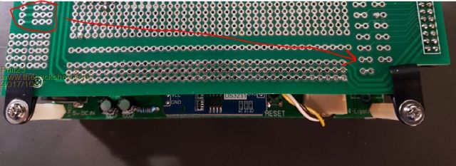

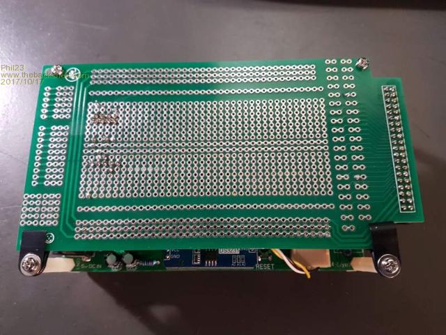

Posted: 04:39pm 16 Oct 2017
No,
I figured you'd need to lose a bit here & there.
Maybe with the gained width, you could also add 3 x 4 hole strips to the other end to give users a anchor place to jump the console port up to if desired.
Bit like what's on the left, but reversed.
3x4, 3x3 or even 3x2, whatever works.
Phil.
Edit:-
Probably doesn't matter if the connector is OUTSIDE the E100 footprint either,
would allow people to create a tighter sandwich if needed, just have to have a case to accommodate it all.
Then maybe the stand-offs could be shorter & components on the other side.
(Thinking out loud).
Edited by Phil23 2017-10-18

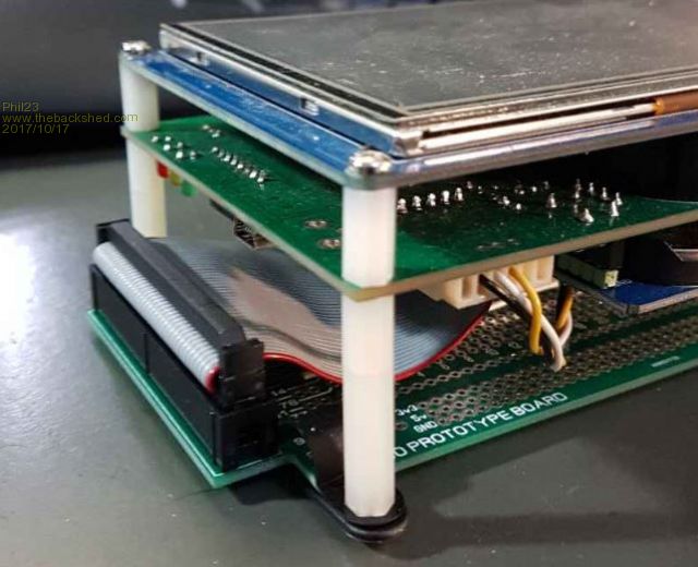

Posted: 04:50pm 16 Oct 2017
He's how the connector sticks out at the moment.
That's not much of an issue I don't think.
More a case of whether it has advantages or not.
Those stand-offs are 30mm.
