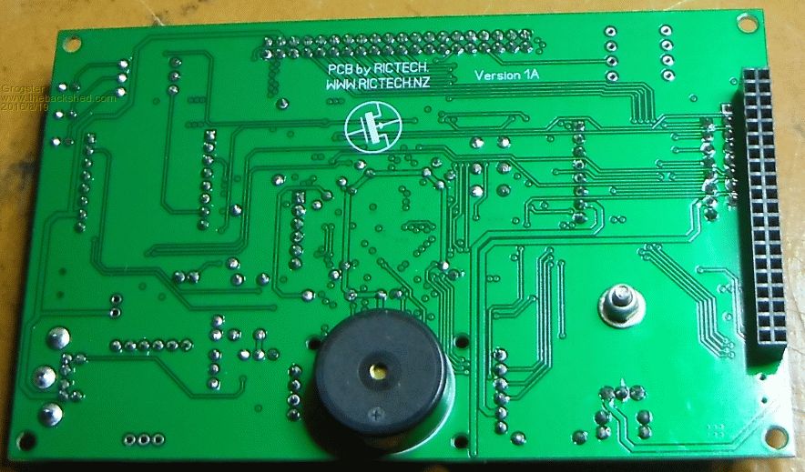

I scraped between each pin as far as I could behind the pins (past the pin lands). I couldn't see any bridge either. I like fault finding anyway.

Hi - thanks for your understanding. I was SURE I did not send any out with bridges, Hopefully yours is the only one.....

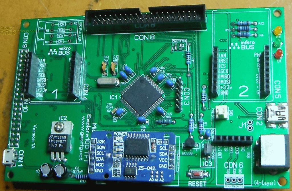

Posted: 10:39pm 18 Aug 2016
Well it Boots up!
Con9; LCD.
Wondering what most are doing with it?
On the top or the bottom of the board.
Blindly put my first on top (5pm after the 3am start).
Then realised if it was on the bottom it could be more of a backpack configuration when used with a 5" screen.
Curious what others think.
Other thing I wondered is; Anything unique about pin 51, the way it's on it's own with a ground.
(Has that Area 51 intrigue).
Cheers.
Phil.
PS.
Compliments to all involved in it's design.
Nice board.
Edited by Phil23 2016-08-20
Posted: 10:44pm 18 Aug 2016
LOL! - I love your Area-51 reference, Mulder.

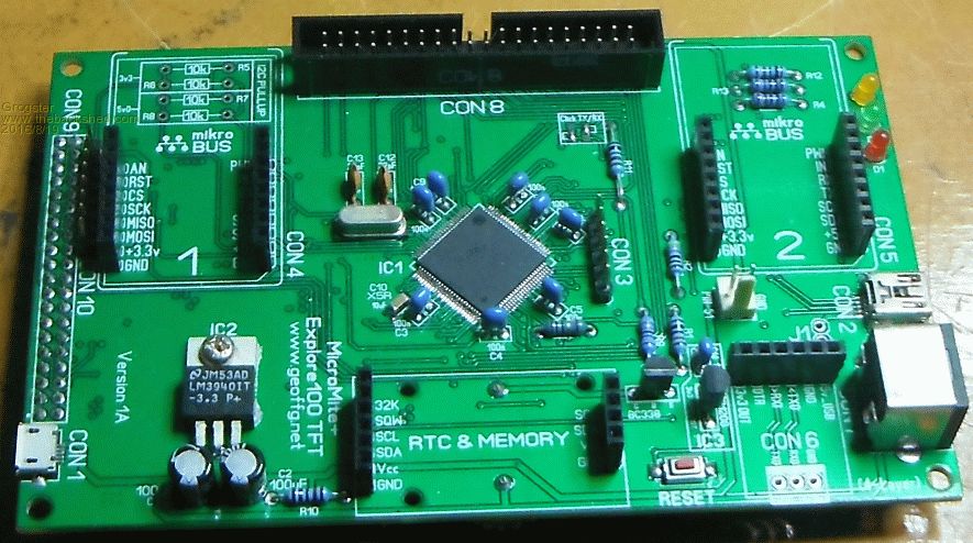

Pin-51 is input-only, and was spare, so it was routed out to that header along with a ground pin, just so you can use Pin-51 if you want to. Better to route it out then leave it buried in the 0.5mm pin-pitch, then people can at least use it if they want to.
CON9 - Female header is meant to mount on the same side as the Piezo, so that you can plug an LCD directly on to the back of it. That is how it was designed to stack anyway. You COULD put a box-header on the top side, and use a ribbon-cable to link to the LCD if you prefer.

Posted: 10:53pm 18 Aug 2016
Hmmmm,
Wondered the when I finished welding....
Con 9;
Don't fancy my chances of removing it.
Should work though if I hang the LCD off the left side though.

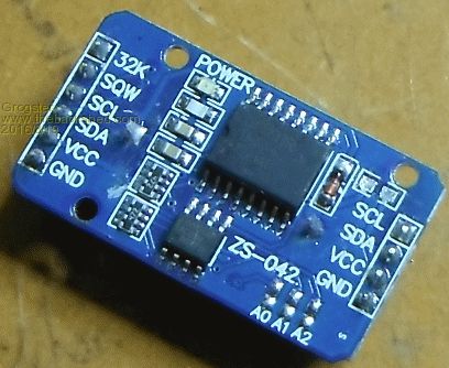

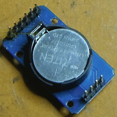

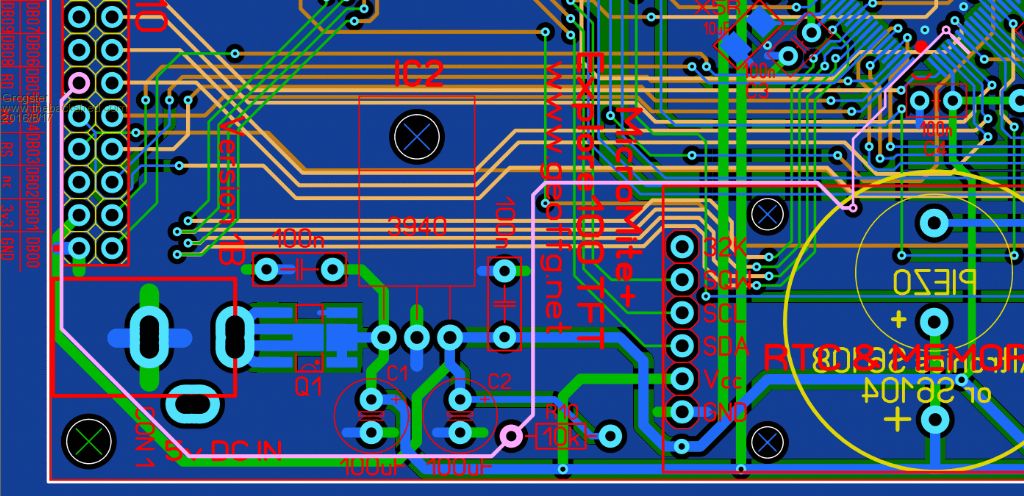

Posted: 11:20pm 18 Aug 2016
You're right - the box around CON9 on the top is a little confusing. I will remove that in any future version of the board, and make sure that is on the other side.
Female headers on the RTC, and you remove the right-angled pin-strips on the eBay-type RTC module, and replace them with straight pins, and then the RTC can plug directly into the board.

unless the piezo is active (ie, a fixed frequency device containing a transistor oscillator and driven by DC), it will be unpolarized. the housings often have a polarity mark simply because it is cheaper for the manufacturer to make just the one type of housing and use it for both active and passive devices.
the 4 pins on one end of the RTC module are passthroughs from the 4 similarly marked pins at the 6-pin end. grogster: might i suggest removing the text markings from the 4-pin end on the next revision of the board, as these pins are just being used for mechanical support?
