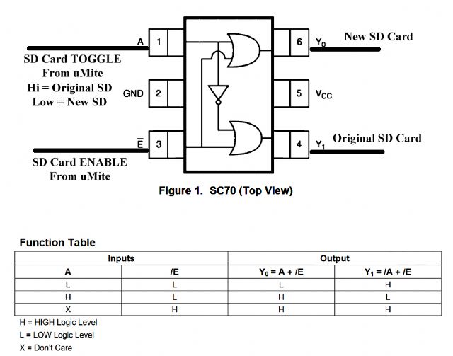

GDay Kon, All,
Why not use a small bit of hardware to do it instead? I don't know about the complications in the software with files open etc but to put an idea into the mix something like this very cheap chip ($0.11ea from Element14)
NC7SZ19P6X
They are also very small at 1mm x 1.5mm in size.
You could set an extra uMite pin as a toggle and wire it like this:
Then it is a simple matter of setting the TOGGLE pin HIGH for the original SD card and LOW for the NEW SD card. If necessary then close any open files before doing the toggle.
Anyway it is an idea that may fix your issue.

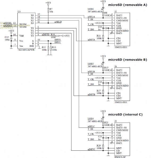

Hi Mick, this is somewhat similar concept to what I am using. It is possible for me to modify the MMbasic so it can support more devices. I am reluctant to do that though, because once out of the mainstream development, I would need to do that with every next revision which Geoff releases, and speaking in more general terms, I would much rather stay on the hardware side.

That looks like a pretty good solution Kon. Where is the problem? Do you want to support more than four SD cards?

Hi Geoff,
I don't think anyone ever would need more than four devices. In another device which is also built around the MM, I am using two cards, each one of them selected by its own CS. Obviously one of them is currently not usable because OPTION SDCARD can specify one pin and from that point it is driven automatically.
This part here with the multiplexer is an extract from the schematic of my ELLO 2M computer (which I am planning to release public pretty soon, once I announce it officially). Of course I can drive 'manually' the DRVx pins to select the needed device, but the reasons why I am still not doing that I explained in my previous post.
PS. There is another little function which I think MM is currently missing and I only discovered that yesterday when I actually needed it - the equivalent of ~ in C. Maybe something like NEG()?Edited by kiiid 2016-04-24

  kiiid said  Of course I can drive 'manually' the DRVx pins to select the needed device, but the reasons why I am still not doing that I explained in my previous post.
Ah, that would be the perfect application for a small BASIC sub placed in the library.
Something like this:
Sub SDCARDn as Integer
Port(pin, 2) = n
You would then have your own command (SDCARD) without hacking the source.

Yes, it would be perfect. I have thought about it, but wanted to leave the entire system 'blank' and available to the user :)

I may be missing something but I don't understand how multiple SDcards can work sensibly. The cards need initialising into SPI mode on insertion but the MM firmware controls this and makes assumptions about the initialisation status and AFAIK doesn't ever initialise when a file is already open. What it does at other times depends on whether card-detect is implemented in the OPTION command.
I have made a tentative start at replacing the Microchip SDcard routines with FatFS which has proper Multiple volumes (physical drives and partitions) and long file names. I've got the FILES command working and therefore most of the underlying basics but it probably needs a couple of weeks on concentrated effort to do a complete replacement (well worth while IMHO). The biggest issue is integrating in with the SDcard error handling in the MM firmware which seems to be spread amongst a number of modules - Geoff: you know this part of the code so much better than me it would take you a fraction of the time.
Thoughts?

  matherp said
Thoughts?
Peter, these are my thoughts. As far as I know, once initialised a card remains in this state until the power is removed. A simple one-bit flag can be used to determine whether a card has been initialised or not. The card detect signal can be simply polled to find out whether already initialised card has been removed, or a card which is not been initialised so far - inserted. Beyond the point of initialisation there isn't anything much more than selecting which card to address by asserting its CS.
If I am missing some detail in this, disregard my comment

  kiiid said  As far as I know, once initialised a card remains in this state until the power is removed. A simple one-bit flag can be used to determine whether a card has been initialised or not.
The problem is that the Microchip SD card routines (which are at the core of the MM+ support) only have one file table. So, when you switch from one card to the other you would have to close all files, flush the buffers and initialise the new SD card. Then the same when you went back to the first. You could not access two cards simultaneously - instead it would be like replacing one card with another.
