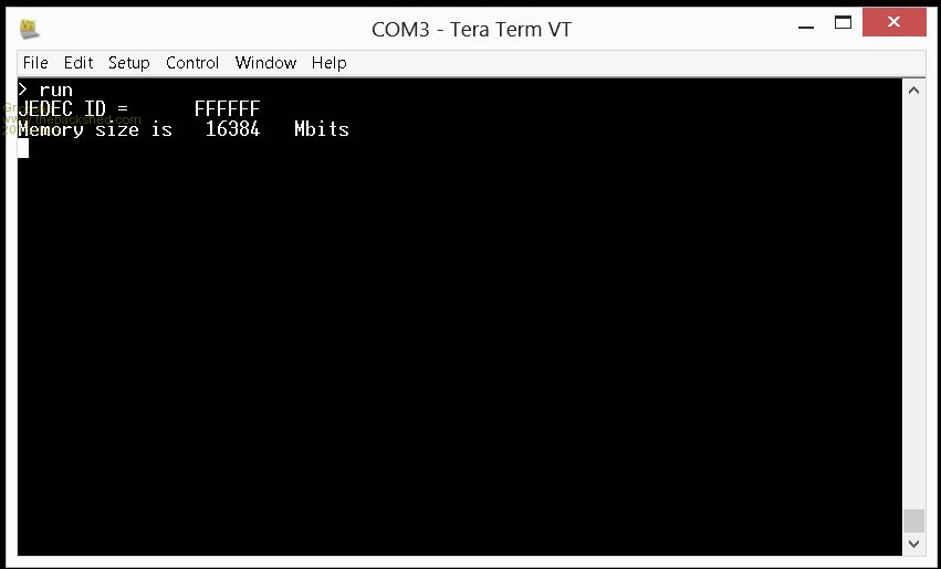

I can't get the test code(matherp's MM+ code) to respond past this point:
You have to press hardware-reset to recover - CTRL+C does not work.
My instinct is telling me that the JDEC ID being FFFFFF means perhaps no response from the SPI chip?
EDIT: Also, this chip(W25Q80BV) should be getting ID'd as 8Mbit, not 16Mbit....
CS pin is correct - 14 in this case, and yes, changed line 4 to reflect that.
I have fitted a chip to a 5" LCD module, in the spare footprint, and connected F_CS to pin14 of the MM+.
The problem might be that F_CS is connected to 3v3 at the moment, so I knew that pulling CS low would short out the power supply via the MM when pin14 goes low, so I have a 4k7 in series with pin14. However, this is probably where the root of my problem is, yes?
The MM+ cannot pull the CS line low enough, with a direct connection to 3v3 on the CS pin, and 4k7 to pin14 on the MM+, correct?
F_CS is on an internal layer of the controller PCB which is four-layer, so cutting the direct connection to 3v3 on F_CS is difficult - hence the 4k7 in the pin14 side of things, but I think this is making the SPI chip deaf as a post to the MM+ trying to pull CS low, personally.
Any comments, suggestions, confirmation of my thoughts etc welcomed.

  Quote  The problem might be that F_CS is connected to 3v3 at the moment
????? Not on any display I've tried (3.2", 4.3", 5", 7")

Sorry if my post was confusing. The controller board that the LCD plugs into, is a four-layer board, and one of the internal layers of that board, connect F_CS to 3v3.
I have run out of brain-power tonight, as it is 3:45AM, but tomorrow, I will hook up an Explore64 module to the LCD with jumper wires, which will allow me to get access to the SPI memory chip without the other controller board with the internal layer connection, which I am pretty sure must be what is stuffing things up.
I was just hoping to use a board I already had made, but that is not going to be the case. No biggie - will post another update tomorrow.

If the CS pin is tied directly to 3.3V then a 4k7 resistor to the MM pin won't be any good whatsoever as all you will do is drop 3.3V across the resistor when the MM pulls the line low - CS will still have 3.3V on it!

No matter WHAT you do, with CS tied directly high, you can't ever pull it low enough to make it respond, so it stays deaf to commands forever.

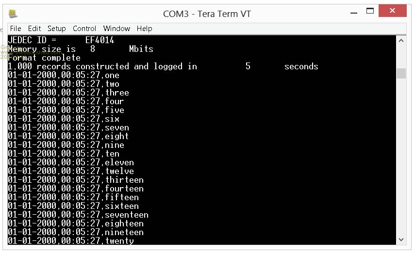

Posts: 10081
Posted: 11:55pm 29 Apr 2016
Yep, that was the problem......

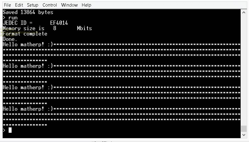

I'm impressed with the demo program - 1000 records written to the SPI memory in five seconds. 200 per second! That's really quite impressive on the speed. I don't think you would have a hope of getting that kind of speed out of I2C would you? Even at 400kHz. I know there are high-speed I2C EEPROM's now, but my new love in memory is SPI type.
Wow.
The tinkering begins........Edited by Grogster 2016-05-01

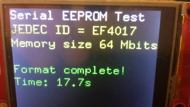

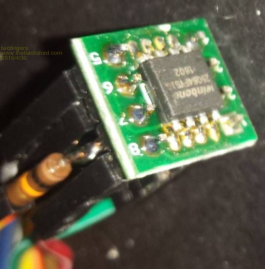

I use a MX170/28PIN/48MHz (Micks Backpack170) + W25Q64FVSSIG (8MB) and I needed only to make one very little modification.
Sub formatlog(cspin As integer) 'erase the chip and set up the page index
Local integer i,bytecount,r(2)
Local s$ length 10
Timer=0
SPI open 20000000,3,8
Pause 100
bytecount = getpagecount(s$,cspin)*256
gives me this:
JEDEC ID = EF4017
Memory size is 64 Mbits = 8388608 Bytes
Format complete! Time: 17.837
1,000 records constructed and logged in 7 seconds
01-01-2000,02:11:41,one
01-01-2000,02:11:41,two
01-01-2000,02:11:41,three
01-01-2000,02:11:41,four
01-01-2000,02:11:41,five
01-01-2000,02:11:41,six
without the PAUSE command I got something like this (after a rerun):
JEDEC ID = FFFFFF
Memory size is 16384 Mbits = 2147483648 Bytes
My MX170/28 connections (CS=24)
' pin 1 (chip select) - connect to any Micromite output capable pin MM-24
' pin 2 (Data out) - connect to the SPI-IN pin on the Micromite MM-14
' pin 3 (write protect) - 10K resistor to 3.3V MM-VCC (10k)
' pin 4 (GND) - connect to ground MM-8 (GND)
' pin 5 (Data in) - connect to the SPI-OUT pin on the Micromite MM-3
' pin 6 (Clock) - connect to the SPI-CLK pin on the Micromite MM-25
' pin 7 (Hold) - 10K resistor to 3.3V MM-VCC (10k)
' pin 8 (VCC) - connect to 3.3V MM-13 (VCC)

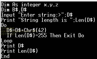

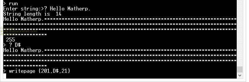

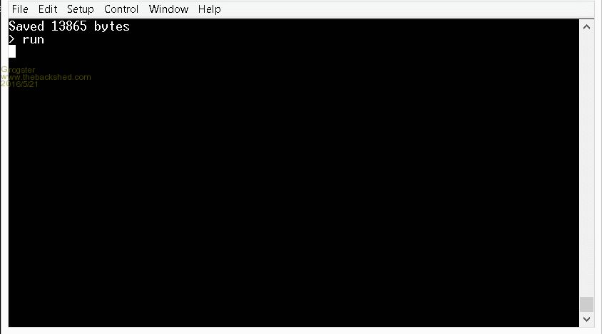

matherp - I cannot make these routines work when separated from your example code.
Trying to call WRITEPAGE crashes the MM+ and I have to press reset - CTRL-C does not get me out of this issue.
Initial test code ran first, and that completes fine, and reads back fine, so I know that the MM+ is indeed talking to the SPI memory.

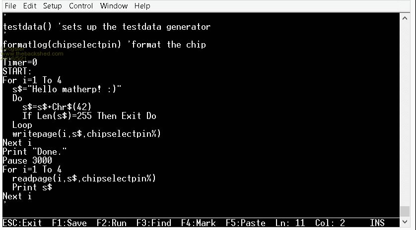

My test code is:
...and the results are:
Note that I am building a string with a length of 255 bytes to write to the SPI memory with the writepage sub. This is shown on the console.
As soon as I issued the writepage command, the MM+ crashes.
Can you offer any reason for this?
Posts: 12091
Posted: 05:46am 20 May 2016
I've no idea what you are doing wrong but the attached is a simple example of direct page read/write (MM+, SPI2 version).

With the above example of mine in mind, and bearing that it is 255 bytes long, can you state if my method at the command line SHOULD be working but isn't, or do you happen to think that this would not work anyway?
IE: Can the Csub's for read and write be run from the command line? Perhaps they have to be inside a running code - I have not tried that, so I will also test that theory.
I believe that I have the command syntax correct, and D$ in my example is 255 bytes long, so that should keep the CSub happy, I would have thought.....

Here are some screenshots.
My code changes:
The result of four write/reads:
Now, if I comment-out line 12:
Posts: 12091
Posted: 01:48am 21 May 2016
The SPI channel needs to be open to use read and write page commands. This is normally done if a TFT display has been enabled (OPTION LCDPANEL ...) or if you call getpagecount. If not you need to explicitly open the SPI channel. In the case of the example you could do this with
SPI2 open 10000000,3,8
