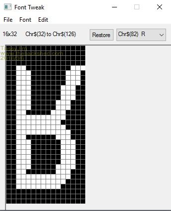

Another one for WW to try.
It should have fixed the issues raised in the last post.
The only addition is the mouse wheel now scrolls the image up/down when using large fonts.

Posted: 09:15pm 04 Mar 2016
This update lets you load/create fonts with any width (within reason).
The only requirement is that the width x height is a multiple of 8.
This change needed a major redo of some critical areas so I need test reports.
I have also made the file reading a bit more forgiving with the file formats.
If you come accross ant files that don't read correctly, please send me a copy and I will investigate.
It should now prompt you to save any changes before loading a new file.
The ZIP includes the 12x20 font that is built in to MMBasic as a BAS file.

Posted: 08:32pm 05 Mar 2016
For WW:
FontTweak is written in PureBasic.
For everyone else, normal black and white still goes...
This update adds flip and rotate as well as menus.
Ctrl-left and ctrl-right step you through the characters.
I even included a help file.
2016-03-06_063151_FontTweak.zip

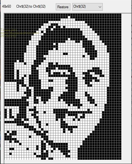

Posted: 08:03pm 11 Mar 2016
Working on the next step:
The image is of a 48 x 60 character but the font below is 64 x 80

Trying to get a decent black and white from a photo can be challenging and takes a bit of tweaking.

Posted: 09:36pm 11 Mar 2016
The image to font code is not in yet.
I still have a lot to do to make it usable but I am making progress.
All the RinkyDink files only have one font in them so no point in skipping the first one!
There are some BAS programs that have two or more fonts embedded.
This is where you might want to skip over fonts to get to the one you want.

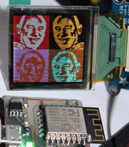

Posted: 10:28pm 11 Mar 2016
Someone had to do this . . . . . . .
Move over Andy Warhol !!!
paceman
Joined: 07/10/2011
Posted: 02:48am 12 Mar 2016
We want Marilyn! We want Marilyn!
Jim - getting better and better; move over Apple art! The auto file select is very handy too - I was about to suggest the OPEN default be changed to .BAS but you're way ahead. Great stuff.
Greg
