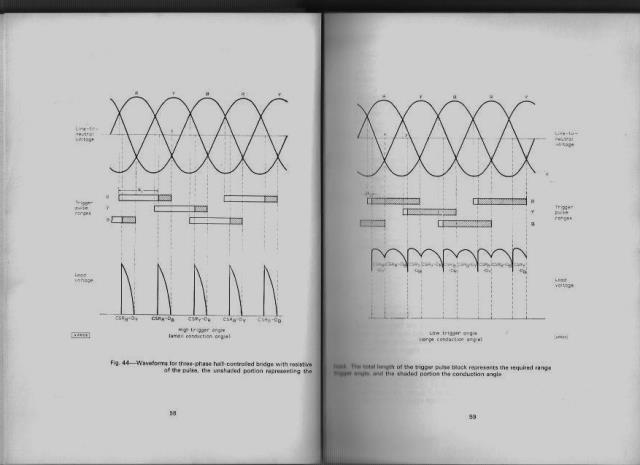

Here are some voltage waveforms for a three phase half controlled bridge.
With very late triggering (and a low output) the SCRs operate independently pretty much as you would expect.
As you advance the firing angle to be earlier, a curious double hump appears beyond sixty degrees and the whole nature of the waveform changes.
The waveforms below are for a resistive load.
Its a very difficult thing to visualise or to explain, you really need to watch it happen on an oscilloscope.
There are many waveform variations possible, a bridge can be half controlled or fully controlled, and the load may be resistive or inductive or a mix of both. There may also be a flyback diode fitted, and sometimes not.
And the waveforms can totally change their shape at some point in the control range.
Its been a very long time since I played around with any of this, so would be starting out from scratch trying to remember the precise details. An engineering textbook or internet search might be your best bet.
Cheers,  Tony.

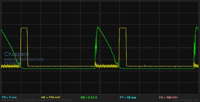

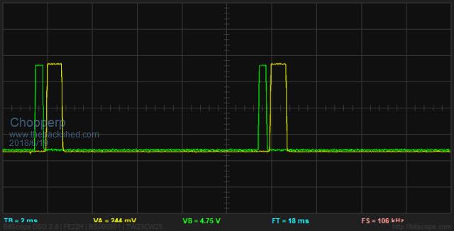

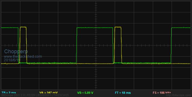

Oneshot pulse (green) occurring just before the next trigger pulse (Yellow). Min O/P

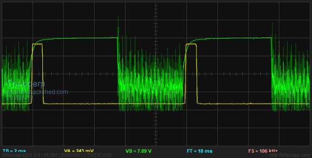

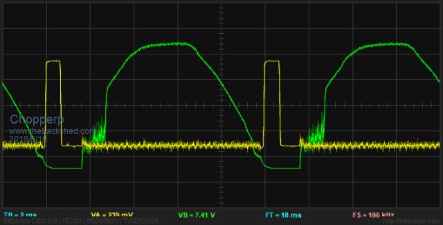

Oneshot pulse at about 50%. About half power

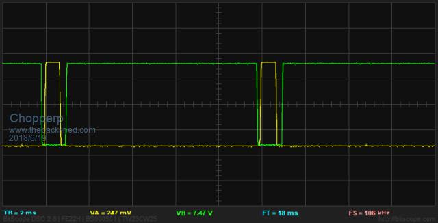

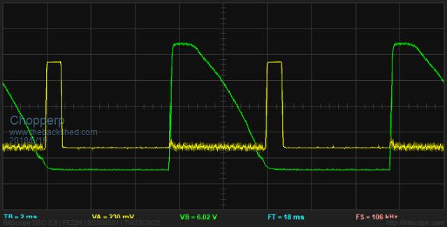

Oneshot Pulse occurring just after the trigger pulse. Near full power

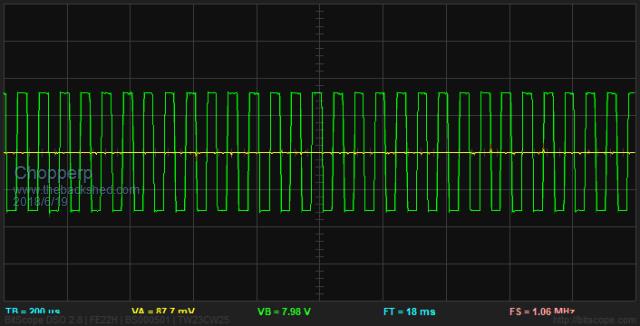

The PWM O/P Trigger signal (15000kHz)
Combined (gated) Oneshot & PWM pulses at about 50% (inverted)
SCR output pulse at about 25%
SCR Output at about 50%. Note flat top AC
SCR Output at about 80%.

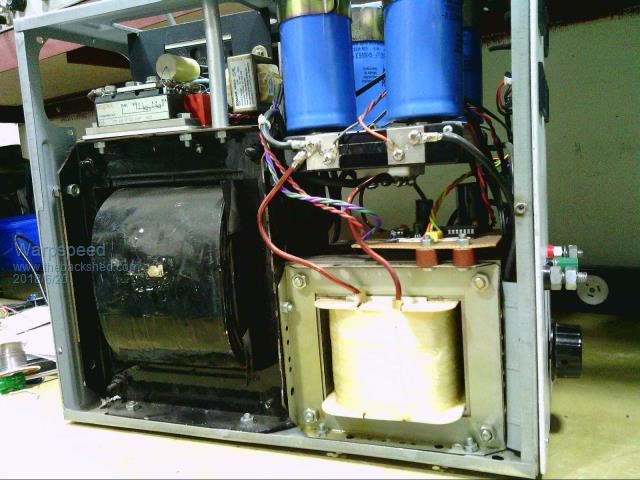

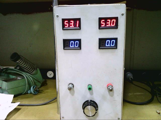

I built a Frankenstein bench power supply into an old computer case.
0 to 100v (+50v and -50v) at 25 amps.
It just has a big knob and uses phase control on the mains side of the transformer.
As rough as guts, no voltage regulation, no current limit.
The main circuit breaker just pops if I have an "event" <grin>.

Looks impressive. I was going to ask you what you did for current limiting. A 2" nail by the looks of it . I thought I had some rectifier / thyristor blocks like you have up in the top LH corner, but just had a look & can't find them. Got a huge darlington transistor left though. Out of an old UPS.
What is your minimum load current before the choke stops choking. I assume it's a choke input arrangement?
I have an old Lester 36V / 20A phase controlled charger I'm not using. It has a centre tapped secondary with an SCR in each leg. For a start, I might bridge the total secondary & put the SCR after that. (Don't like controlling the mains input though it would be more efficient). Not sure if it will have enough volts to have an input choke though. Should give me 10A.Edited by Chopperp 2018-06-21

Chopper,
Its a centre tapped transformer with a bridge rectifier. Two chokes, and two plus two 22,000uF 63v electrolytics to give me positive and negative supplies with respect to ground.
This is a real junk box hot rod special, only things I had to buy for it were the digital panel meters and some 12v plug packs to supply dc to the control system and panel meters.
I don't worry about fine details like like voltage regulation.
Just wind up the wick until the load comes to life, and that is about it.
Its only ever used for those quick dirty jobs....
The chokes were made for me by a long term mate that has a transformer winding business. I don't know what they are worth, this was a freebie return favor job.
Each has a one and a quarter inch stack of two inch laminations with a 1.5mm air gap.
There are 72 turns of 6mm x 2mm rectangular copper.
No load inductance measures as 4.24mH
It still has 3.07mH at 25 amps dc.
If I ever did measure the saturation limit, its not on my now ancient scrap of paper in my file.
Thought this might interest some of you blokes that probably have a mountain of similar old parts out in the shed just sitting around.Edited by Warpspeed 2018-06-21
