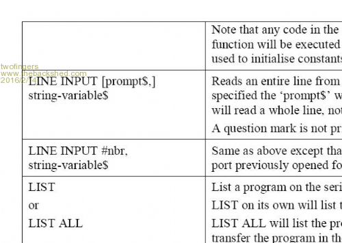

Hi Geoff,
respectfully I want to propose two minor corrections about the user manual v5.1.
1. In the command list (p.61) I miss the LINE command for the LCD panel.
This command is already described at p.21.
LINE X1, Y1, X2, Y2, LW, C
Draws a line starting at X1 and Y1 and ending at X2 and Y2.
LW is the line’s width and is only valid for horizontal or vertical lines. It defaults to 1 if not specified or if
the line is a diagonal.

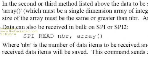

2. In Appendix D – SPI Communications
Here are references to a SPI2 (p.91/2).
I thing this is maybe wrong for standard Micromites (MX170/28)? I can not find a SPI2 channel. Maybe this applies to the MM+ (I think so!)? A remark would be helpful.
I know there is a way to create more than one SPI channel (CFunction).
Michael

Thanks Michael. I will put the changes into the manual for the next version.
