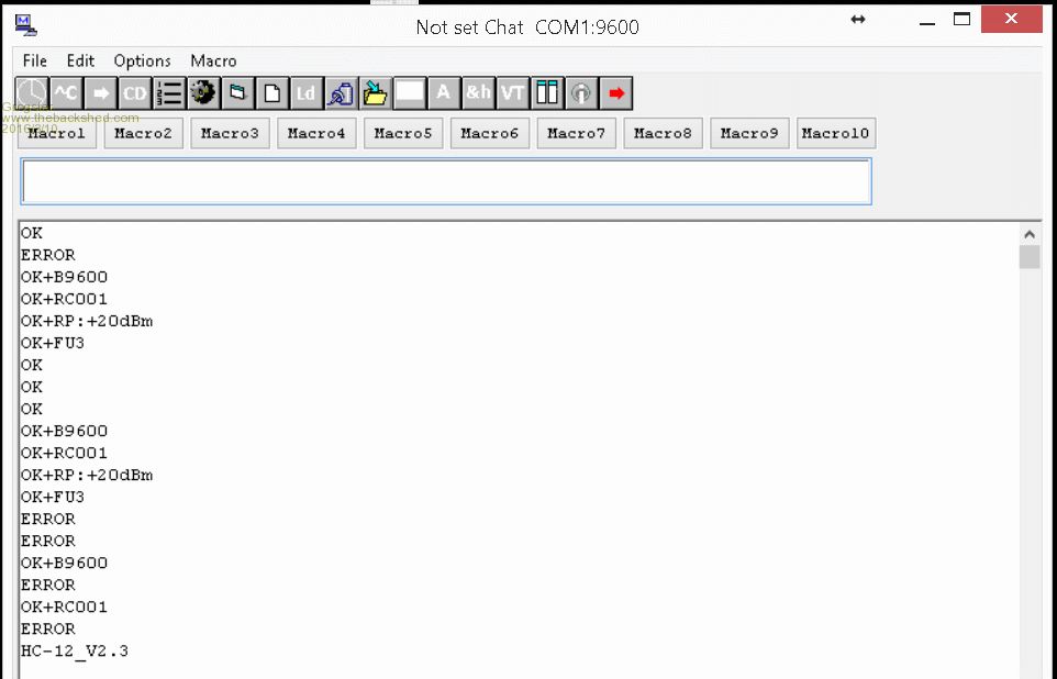

The module responds to "AT+A001" or "AT+A012" kind of command with an "OK", but attempts to query that command with the likes of "AT+RA" result in an error message.
My guess is that it is possibly ignoring commands from the earlier HC-11 module, for compatibility reasons. The module DOES NOT respond with "ERROR" when you issue "AT+A012", it just responds with "OK" but nothing else. Not sure if this helps at all, or makes matters worse!
EDIT: It does seem to be ignoring unknown commands, and sending "ERROR" for syntax errors in commands it does know. If you send something like "AT+ZZ" or "AT+OO", the module still responds with "OK".

using the HC-11 configuration utility with an HC-12 module attached, the response from sending "AT+A003" is "OK". this is not the expected response, but neither is it an error.
the HC-11 and HC-12 use completely different transceiver chips from different manufacturers. i would not expect the address command to be supported by the HC-12, and the "OK" response may just be there to provide some level of drop-in compatibility. note that an HC-11 can not communicate with an HC-12, even if the operating frequency of both are the same.

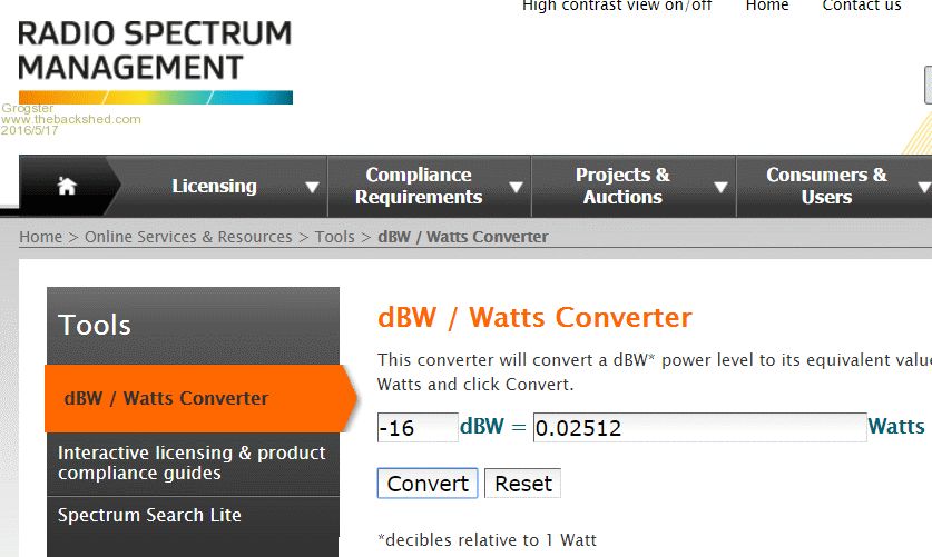

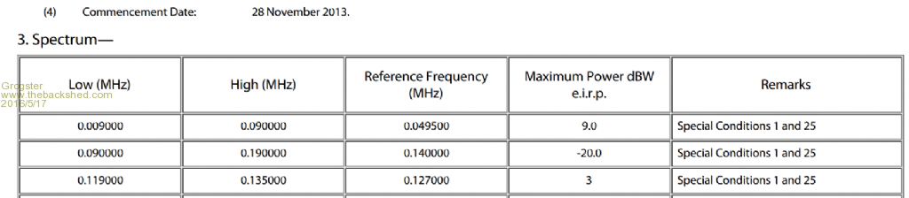

New Zealand allows up to 25mW on 433-434MHz band, sporadic transmission only. Continuous data streaming etc, is NOT permitted. Voice on those frequencies is also not permitted.
These regs are from 2013, but 433MHz band regs don't often change - in NZ at least.
