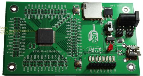

boss
Joined: 19/08/2011
Posts: 268
Posted: 07:57am 11 Jul 2015
Hi everyone,
I found this PIC32MX470L (100pin) board on eBay.
It maybe good starting platform when the 100pin FW will be available
http://www.ebay.com/itm/Microchip-PIC32-PIC24-dsPIC33-USB-OTG-Development-Board-Starter-kit-SD-Card-/181197009902?pt=LH_ DefaultDomain_0&var=&hash=item2a302ef3ee
Bo

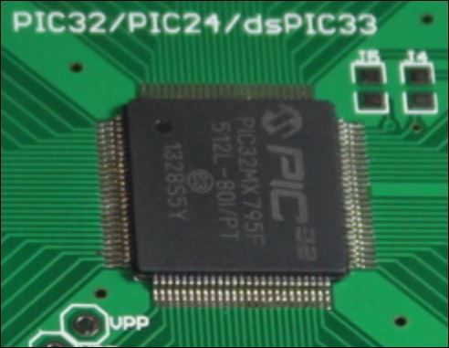

BobD
Joined: 07/12/2011
Posts: 935
Posted: 08:21am 11 Jul 2015
Bo
Although they are very careful not to say, that board looks like it is a PC32MX795F512L. That was used in the Maximite several years back.

boss
Joined: 19/08/2011
Posts: 268
Posted: 12:51pm 11 Jul 2015
@BobD
They have 4 CPU to choose from including 32MX470L. Check on eBay. The board is the same, just the chip is different.
Bo
boss
Joined: 19/08/2011
Posts: 268
Posted: 01:01pm 11 Jul 2015
@Peter
The seller is a Czech fellow and I believe you can kindly ask him to remove RTC 32kHz crystal and related capacitors and replace 8MHz crystal with 20MHz as well. The board price is around ~30 bucks and the shipping ~ $3.
Bo

boss
Joined: 19/08/2011
Posts: 268
Posted: 07:57pm 11 Jul 2015
Hi everyone and greeting from Vancouver ,
I had some chat with the seller because there is necessary to do some changes on the board:
1) Replace 8MHz crystal with 20Mhz Xtal
2) Remove 32kHz crystal and associated capacitors
The seller agreed do this mod for not extra charge, there is his post:
The seller is located in the Czech republic, so I wrote the mod request in Czech. But seller prefers communication in English
Dear kovois,
Hi
Let's speak English:)
Yes, it is possible.
You want a SnadPIC board MX470 which has 20Mhz crystal, and remove the 32khz and its capacitors, so RC13 and RC14 will be available,
But the board will be RED .(not green)
OK,you can buy the green 470 device and we will make the changes you want.
Just leave a note (message) : just write : NEED CHANGES to let us remember.
best regards
Bo

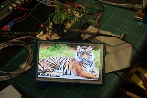

Thanks Boss for the post on the SNADPic PIC32MX470F512L module. I have just ordered one of them with the mods negotiated by you. It looks like a great board and I will be using it to develop and test the 100-pin version of the MM+. Much easier than my current test setup (in the top part of the photo below).
GeoffEdited by Geoffg 2015-07-13
