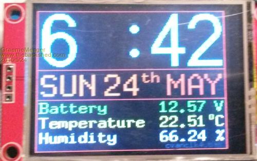

Here is the code I am using and I am trying to shift the single digit hour across one space or specified character before the digit.
If Val(Left$(Time$,2)) < 12 Then
Text 5,1,Left$(Time$,2),LT,2,2,RGB(Cyan),RGB(Black)
Else
Hrs=Val(Left$(Time$,2))-12
Text 5,1,Str$(Hrs,2,0,"-"),LT,2,2,RGB(Cyan),RGB(Black)

Hi Graeme and Geoff,
I've just tried it and there does seem to be a problem with the STR$ function. STR$(hrs,2) only returns one character if its <10 hrs.
When I was using it with the Micromite 1, V4.5 and with the LCD command it was working correctly.
The following is a workaround:
hours = VAL(LEFT$(TIME$,2))
IF hours < 12 THEN
IF hours <10 THEN
Text 5,1,"0"+STR$(hours)+":",LT,2,2,RGB(Cyan),RGB(Black)
ELSE
Text 5,1,STR$(hours)+":",LT,2,2,RGB(Cyan),RGB(Black)
ENDIF
ELSE
hours = hours-12
IF hours <10 THEN
ELSE
ENDIF
ENDIF
You can replace "0" with " " of course if wanted.
GregEdited by paceman 2015-05-25

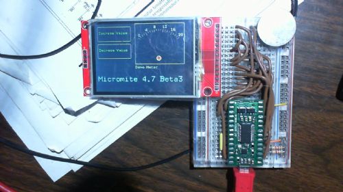

Zonker
Joined: 18/08/2012
Posts: 772
Posted: 09:02pm 24 May 2015
Morning Gents...
I finally got a chance to play with the new firmware... Nice..!
I went back to the TFT MM demo programs and converted a meter object to the 2.4 inch touch panel to play around with... Still working on it...
2015-05-25_070042_2-4_inch_meter_test.zip

Yes, nice job Zonker. I've got it running on a 2.8" with exactly the same code and connections and it looks great. It's amazing how much extra display area there is with the 2.8" screen - it's 7.8 sq" Vs 5.7 sq" and not much different current draw, about 50mA directly off the 3.3v supply.
Greg

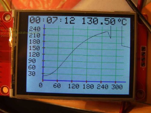

twofingers
Joined: 02/06/2014
Posts: 1782
Posted: 07:10am 25 May 2015
  Geoffg said   There has been a lot of comment on the loss of the SPI channel to the display/touch controller.
hmm, seems the MM lost his SPI ability? (if you don't disable the LCDPANEL)
... I wanted to use the new LCD capability with a SPI thermocouple circuit (MAX31855). I got it already working with Peters Graphic library.
A display for my Reflow-(Pizza)-oven (3x SPI: LCD, Touch and MAX31855 thermocouple amplifier).

twofingers
Joined: 02/06/2014
Posts: 1782
Posted: 09:56am 26 May 2015
  viscomjim said   Hi Twofingers, are you saying that if you disable the lcd then you can do your spi temperature measurement and then re-enable the lcd and this will work?
Hi Jim,
with Micromite V4.7 Beta 3 I can only use SPI with PeterMs Graphic library
(OPTION LCDPANEL disable, OPTION TOUCH disable).
  viscomjim said  Also, are you using a pid profile with your pizza oven? Just curious.
No, I don't use a pid profile. The oven runs at full power with manual power off. I think that's good enough. I use the Micromite only to observe the temperature.
But I'm prepared to control the SSR by MM. For that I have to isolate (fiberglass mat) the oven better.
To build up a oven control is a challenge, I think.
Today I encountered some issue with GUI CALIBRATE. I get always a calibration error regardless how exact I execute the calibration process. I can't use the Touch function. With PeterM's Graphic library there are never problems. Perhaps can someone help?
Michael
