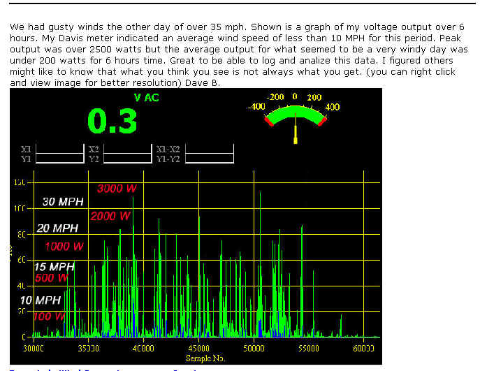

Just a minor point regarding feed forward from an anemometer.
Unfortunately there is a lag time between increased wind speed and windmill response. This is not so much an issue in times of steady consistent wind, but in gusty conditions the peak wind power is never reflected in output power.
Comment from a Fieldlines Forum contributor:
For this reason anemometer sample rates are made the same as windmill response times when used for power calculations. Of course response times vary between different mills for a number of reasons. In general smaller diameter props respond faster to gusts than larger ones.
Perhaps in considering response times the feed forward signal could eliminate this variable by coming from prop RPM instead of anemometer RPM?
Cheers Gill _Cairns, FNQ

GWatPE
Joined: 01/09/2006
Posts: 2127
Posted: 04:22am 14 Oct 2007
A few comments.
I have used PID systems myself.
Air conditioner control. good use here, long system responce time constants.
Heater element control. This was much faster response, 800 C and arount 200W heater. Even with auto tuning PID, settings for propotional Band, Derivative action time and integral action time still caused oscillations. These PID systems were designed for control of Process systems with long system time constants. Analogue computers provide the best control here. digital is catching up, but processing power would use most of mill output.
The graph I posted shows that complete wind gust transients can occur within a 20 second period, from close to 0 power output, to max and down again. Mini gusts can be less than 1 second duration.
The response time of the control has to be 100 times faster than the minimum system response time constant to prevent oscillations.
It would be possible to use a cup anemometer to measure wind speed and then use a direct control system to control the modulator. The actual power of the mill at all windspeeds expected has to be known. There should be compensation for air temperature as well. We have all seen that power output falls on hot dry days.
Gill, what sample rate is the data collected at, and what colours mean what?
Maybe you could post a zoomed in portion over say a couple of minutes.
I assume the green spilkes are wind gusts and the blue the mill power?

Gill
Joined: 11/11/2006
Posts: 669
Posted: 11:36am 14 Oct 2007
Gordon,
Sorry mate that is not my graph so I can't relate the values. I guess the same as you. I used that post from another forum to highlight the mill response lag where in gusty conditions a fast responding anemometer will register high velocity wind but the mill will never reach that corresponding rpm before the gust is gone. ie. response time exceeds gust duration.
Just thought to mention this for consideration.
GWatPE
Joined: 01/09/2006
Posts: 2127
Posted: 10:11pm 14 Oct 2007
Thanks Gill,
I guess that a picture can tell a thousand words, but we still need an interpreter.
If we post graphs etc, of measured data, a legend with some explanation should be provided, so comparisons could be made.
we have to be careful comparing measured data and predicted values.
an example of mill output v windspeed is only useful if the blade area is given as well.
30mph wind on an Air-X would not be comparable to a F&P with 3M dia rotor in same wind.
cheers, Gordon.
