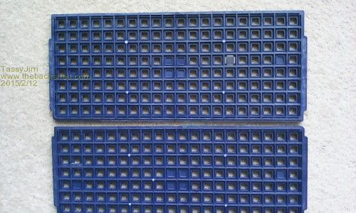

Posted: 03:50pm 11 Feb 2015
My PIC32MX470F512 chip arrived today. Just the one chip.
I was a bit taken back by the packaging.
Now I have to wait for the board to put it on.
Posted: 04:05pm 11 Feb 2015
I got my chips earlier this week, but they came in one of those little black Microchip plastic carriers - your shipping method looks pretty big!
Factory is in the middle of Chinese holiday at the moment, so says the S2U website, so I am guessing that although I got my order in, it was right at the start of that, so this means that we have to wait longer then usual for the boards, which is annoying. The website says they are back at work on the 26th, so it is likely to be after that before the boards arrive - a shame, but what can you do? C'est La Vie.....

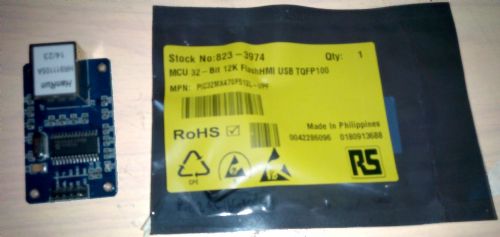

Posted: 08:00pm 11 Feb 2015
Hey Jim,
Mine came yesterday too..
Pictured next to one of those ethernet to serial adapters that I ordered at least 2 months ago (which finally arrived today)..
Yours looks like the 64pin baby..
I ordered the 100pin one..
I hope to mount mine on a UBW32 board.. I need to check pinouts first and work out if its worth doing.
