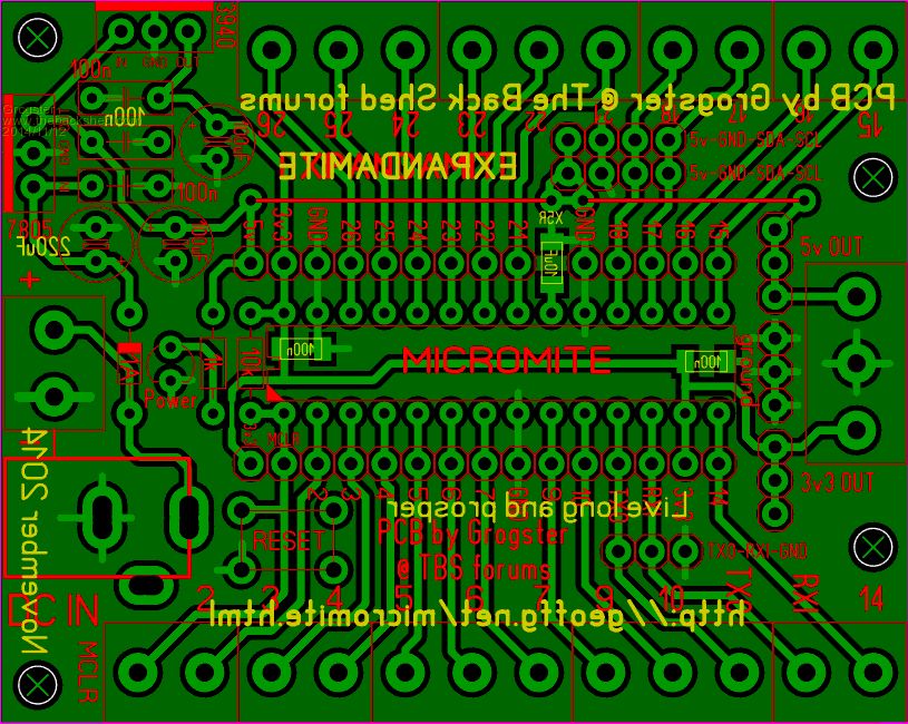

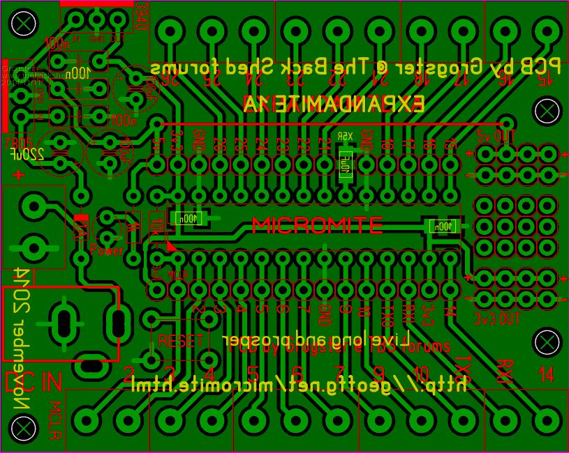

OK, try this one on for size:
I have allowed for either SMD or leaded MLC cap for Vcap. Extra headers added.
Can we squeeze anything else in?
@ centrex: I will be posting the gerbers once everyone is happy. I will also be getting some made, so members can get them from me if they want one, but don't want to bother etching their own one. Any board(s) I supply, would have a SMD 10uF MLC ceramic fitted for Vcap.
EDIT: Swapped two leaded 100n's for SMD versions. It's neater, and not so "Tight". Any boards I supply will have the three SMD parts fitted for you, so all you have to do, is all the other thru-hole parts.Edited by Grogster 2014-11-12

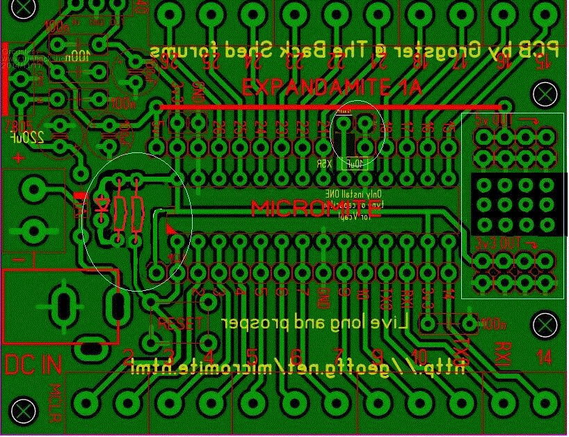

A few more suggestions. I hope you see the value in it, because it comes down to personal preferences and yours are probably different then mine. So ignore if its not valuable for you. :)
I would change the resistors placement slightly so that they can be mounted flat.
Having the resistors stand up right next to the connector will interfere with something you plug in.
This is also the case for the cap on pin 19/20.
Furthermore having a small 'sea of holes' can be very handy for those small addons that always seems to happen.
Smaller power strips for 5v and 3.3v both with their own ground strip.
I made a crude paint version of your pcb with the modifications encircled with blue.
Edited by TZAdvantage 2014-11-12
Posted: 12:14am 11 Nov 2014
Nice thinking - will make the changes.
Stay tuned....
EDIT: OK, how about this?
Posted: 01:13am 11 Nov 2014
Yes. Those smd caps solve some placement problems and the 1210's are easy to solder.
Looking at the t-blocks I see there is no regulated power available from them!
I think you should need at least one GND on a t-blocks.
Don't know how to solve that problem without making the PCB bigger.:(
What are the current dimensions?
Are the outer t-blocks island on the same grid as the connectors next to the mcu?
Posted: 02:11am 11 Nov 2014
T-block on left of PCB has ground connection.
Really is no need, as far as I am concerned, for regulated power at the T-blocks. You have 5v + GND and 3v3 + GND strips to tap into, and also 5v, 3v3 and GND points on the headers down either side of the chip.
PCB size is 69mm x 55mm.
T-blocks and connectors next to MCU are on a 0.3175mm grid.
Posted: 08:13am 11 Nov 2014
The reason for regulated power on a t-blocks is that if you made another module those voltages would be available. Sure you can take it from the pin headers but if you want to use the PCB in rougher environments, like in a car, vibration is your biggest enemy. T-blocks are a good way to minimize that problem.
If that is one of the environments you want to use it in it might be good to drop the 3.3v and 5v headers and put a t-blocks in its place.
It really all depends in what scenarios it will be used.
I often have to fit things in cars so I am thinking along that scenario.
69x55 is very compact. A double sided PCB would not be smaller.
I have a cnc, so this would be a great test to see how it comes out. (if only a day had 48 hours....)
Great job squeezing everything in.:)

Posted: 02:43pm 11 Nov 2014
Hi Cliff.

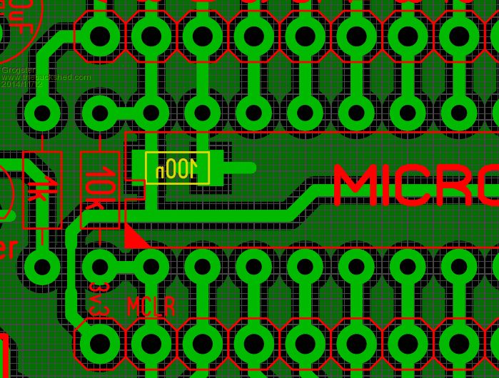

The PIC32 and headers are all standard 0.1"/2.54mm pin spacing, but the underlying grid is 0.3175mm, in order to squeeze everything in, and still allow for neat track layout.
So, if you use a 2.5 grid, you WILL NOT be able to design a daughter-board to fit.
However, if you use a 0.3175 grid, you will have no problems at all with spacing.
All PCB layout software allows you to change the grid size, and most of them let you change it on the fly. Standard practise is to stick to one grid size, but in this case, I have changed grid sizes depending on what I needed to factor in.
However, the PIC32 chip, and the header strips either side, are on a common grid - that being 0.3175mm. Example:
As to closing it off now, you are probably right in that respect!
Unless someone else comes up with a very obvious ommision on my design, we'll call it final for the alpha-1 version.
I will wait till tonight to see if anyone else chimes in with their thoughts.
Once closed, I will upload the ZIP, which will contain the gerbers, the GIF's, Excellon drill data and isolation milling files, for those with a CNC.
I will also be getting some done at Itead, so anyone interested in that option(not having to make their own one), please flick me a PM.
As mentioned earlier, any boards I supply will have the three SMD parts fitted, so all the builder needs to do, is source the rest of the thru-hole parts and build it.(builders need not worry about the SMD - the board will be supplied with those parts pre-fitted)Edited by Grogster 2014-11-13

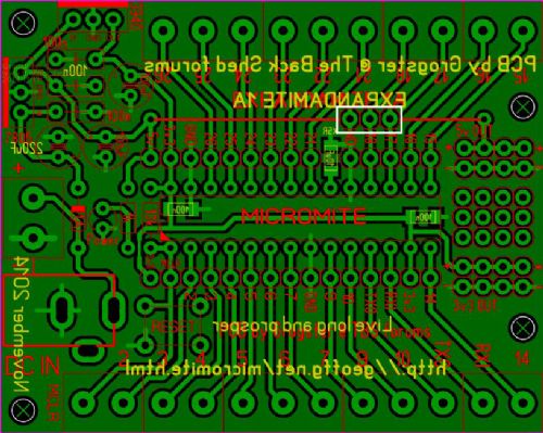

Grogs,
As for the PCF8563 (which IMHO is turning your board into something you didnt intend it for and Single sided is a bit much to expect), However
A simple addition of 3 pads (with no other track modification) as shown in the white box here:
Would enable a PCF8563 plug in module similar to This One
To simply plug in (skipping the Vcc line which should be unnecessary due to the battery)
PS. It also allows a connection to other I2C devices if the module isnt needed.
MikEdited by bigmik 2014-11-13

Posted: 09:23pm 11 Nov 2014
Grogster, I would indeed replace that area with t-blocks.
It will make the board more uniform.
If someone wants to use this board connecting order parts using the t-blocks, they would be able to use the same cables for power. Mixing styles of connections is always confusing so having a complete set available through the t-blocks would be great.
You might be able to have some pin headers right behind the t-blocks to still have those pins available.
Loosing the sea of holes is I think worth it.
I like BigMick's suggestion to have a header for the i2c.Will come in very handy. Try to squeeze in at least 2 rows.
You might do the same for the console pins.
Edited by TZAdvantage 2014-11-13
Posted: 01:57am 12 Nov 2014

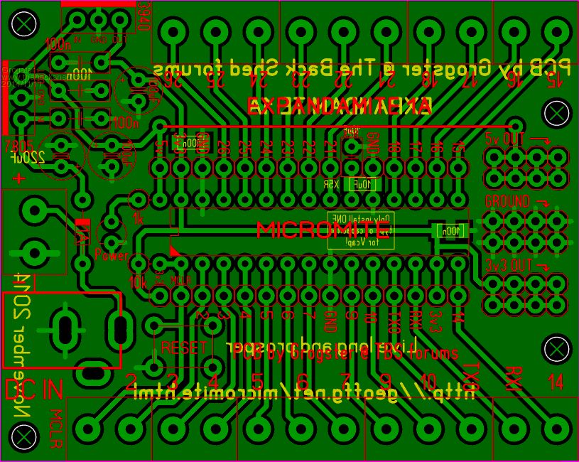

Okey dokey people.
This should just about do it:
Added 2x 4-way headers for I2C - should be pin-compatible with those 8563 RTC modules that Mick linked me to. All things being equal, you can just plug it directly into the board, and you are ready to rock 'n' roll. That module is kinda long and skinny though, so it would probably be a better idea to solder it in for mechanical stability.
Also added a 3-way header for the console.
Whaddya think, guys - done board?

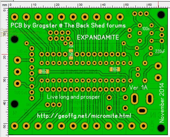

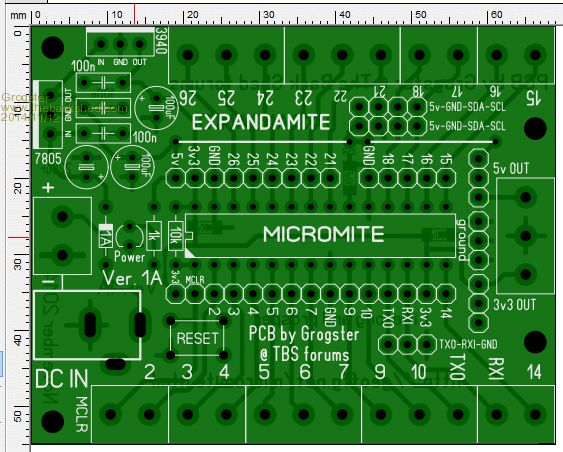

EDIT: Some mock photoviews of the PCB.
Top:(silkscreen)
Bottom:(copper layer)
