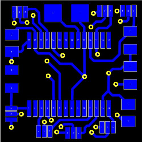

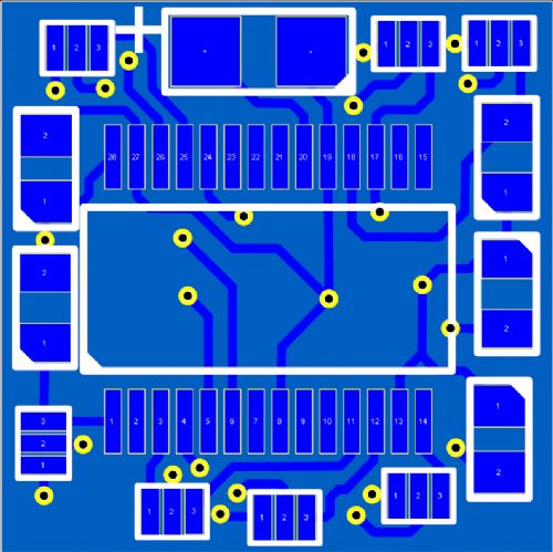

We can do this.. it is a SSOP '170 on a 15mm x 15mm PCB (and it is TIGHT) some clearances are pushed to the limits.. There seems to be some bug in DEX that even though I tell it to use thinner tracks it wont allow me to make them less than 0.01" (.254mm)
Anyway up for critique'
TOP
BOTTOM
OVERLAY (No text yet)

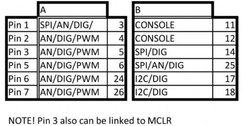

TABLE of link options

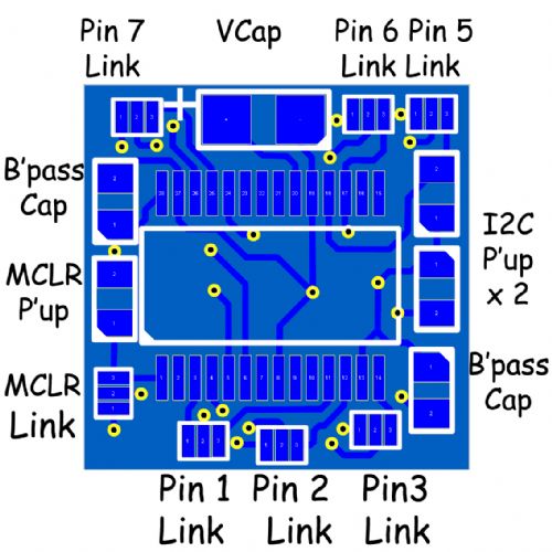

NOTE!! There are two link options for each pin (6 in total) plus Pin 3 can be sub linked to MCLR for programming so pins 2,3 & 4 are a pseudo ICSP header.
Posted: 04:57pm 21 Sep 2014
Lads,
Further NOTEs for MuP-Mini
I have also used those SMT header pins on the bottom layer for connectivity to a standard 0.3" 8 Pin DIP IC socket
EDIT as I said this board is TINY, you can get 9 on a 50mm x50mm PCB. but some track clearances are down to about 0.007"
