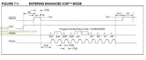

To programme the PIC32, basic wiring should be as for uMite in Geoff's technical manual.
Programming mode is entered using the timing chart shown and then clocking in a 32 bit data sequence "MCHP" MSB first. (wouldn't stand for Microchip now would it?)

Looking at the timing chart, it seems that there may be a problem. Time P17 must be a maximum of 100nSec which is outside the capabilities of MMbasic.
I'll give it a try but might have to do only 4 wire yet (or devise a MCU dongle - which isn't the general idea. Edited by MOBI 2014-04-30
David M.
Posted: 09:32pm 28 Apr 2014
Mobi,
I have gone quiet on BSF as I am currently having a look at this (using ICSP).
What you mention above about P17 is not 100% true about timing (data sheet probably wrong - there's a surprise!). I have recorded and studied a timing capture of an actual programming session.
In this capture I am seeing P17 as 2.5885mS . . . so keep going - it should work fine!!

Referring to the Figure 7-1: ENTERING ENHANCED ICSP MODE shown above.
I have a different version of Figure 7-1 from document: -
DS60001145M
“PIC32 Flash Programming Specification”
2007-2013 Microchip Technology Inc.
On the Figure 7-1 (Page 19) P17 becomes P19 with a specification (Page 59) of Minimum 40 ns.
No Max given.
The DS60001145M perhaps seems clearer than other documents and has had many updates?
Keith W.
MOBI
Joined: 02/12/2012
Posts: 819
Posted: 12:32am 29 Apr 2014
  Quote  In this capture I am seeing P17 as 2.5885mS . . . so keep going - it should work fine!!
Thanks, that saves me cranking up the cro. I did wonder if the P17 could be longer. It wouldn't be the first time Microchip got delay mixed up with rise time. I think the short time constraint is due to needing the MCLR high before any internal timers kick in.
I think the P17 is the only one that is a maximum and all the rest can be mSecs.
