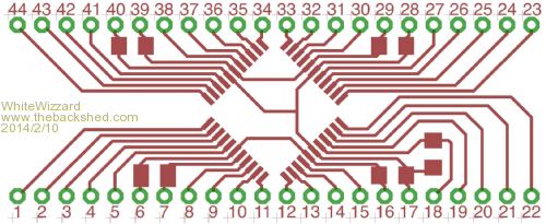

Thats ok Grogster
Note that following:
- Pin 6 or Pin 16 need to be connected to GND (no need for both as these pins are connected to each other on the PCB)
- Likewise, Pin 29 or Pin 39 to GND
- Likewise, Pin 17 or Pin 28 or Pin 39 to +3v3
- not sure if 100% stability is achieved without any decoupling caps so have included the ability to add 3 x 100nF on each of the power inputs (I always include all three simply to meet data sheet specifications - not really a space demand for this PCB, and near zero cost!)
- 10uF-47uF tant on Pin 6 & Pin 7 is a must!
- Don't forget a 10K resistor between Pin 18 & Pin 19 when incorporating ICSP - Do you think I should include this on the PCB?
Let me know if you have any problems . . .

Grogster,
Now its not so pretty!
Heres the mod:
2014-02-10_062013_MicroMiteDIPv3.brd.zip
Let me know if you are able to open the file successfully as I'm on an iMac and it keeps saving it as a windows file Thanks!

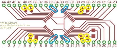

Posted: 04:38pm 10 Feb 2014
Nice compact boards.
I would suggest looking at the traces i circled in yellow.
Those traces connect with a very sharp corner to the pads.
Most PCB houses suggest to prevent this as it can cause 'peelables'.
Page 11 point 10: eurocircuit pcb design rules.
Their automated system will reject those traces.
The traces marked with blue could be straight. Allowing the traces next to it to be a little longer before they go into a 45 degree corner.
Personally i would make the traces the same width as the 44pin pads,but only when it is manufactured with a soldermask.

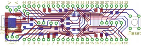

Posted: 06:26pm 17 Feb 2014
I have finally made all the required changes to the 44-pin Eval PCB and am about to place an order with iTeadStudio.
However, it is very late here, I have been in front of the screen for many hours now, and I really could do with some extra sets of eyes to have a look over what I have done.
Hence can I please ask all you wonderful people with Gerber Viewers to run your eyes over the attached files to spot any obvious mistakes!
2014-02-18_041737_MicroMite_v1.zip
I have built several prototypes so I know the circuit design is robust - I am more concerned with the files themselves (i.e. missing files, incorrect format, spelling, etc)
Many, many thanks in advance for your help . . . .

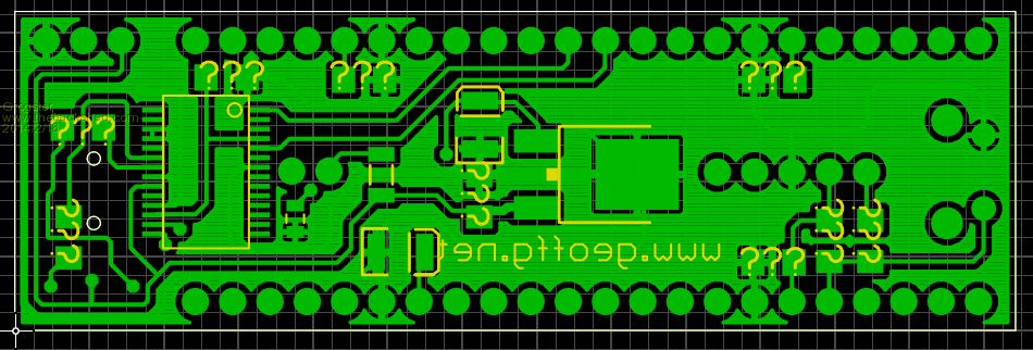

Posts: 10074
Posted: 06:58pm 17 Feb 2014
Very sexy indeed.
Imported fine into Sprint Layout 6, but no drill-data.
I think that is about the only missing file - everything else seems to be there.
EDIT: Some silkscreen missing from some of the copper2(bottom layer, GBO file)?
Some pads don't have any indication caps etc are supposed to be there?
See image below - I have put ??? beside pads I thought were supposed to have some kind of silkscreen ID...
Edited by Grogster 2014-02-19

Posted: 07:08pm 17 Feb 2014
You bet Wiz...
I will have a look after work tomorrow... I found an online Gerber Viewer program you could try and see if it renders well... But, I agree, after someone puts something together, it's better if others have a look... You have been staring at it to long... I downloaded your .BRD file after installing Eagle-6.5 at LOU's house and brought up your design... It seems you made your board using no schematic... Just tracks and (I guess) big vias for the holes and a single footprint of the TQFP-44.. Humm... Are the SMD pads for the caps/resistors just rectangles..? You can set your hole size to 0.035 and create a CAM file to make the EXEClLON drill control file if it's missing from the ZIP.. Don't know cause I haven't donloaded it yet.. Man, almost 11:30 here... Gota get some gip...
Edited by Zonker 2014-02-19
Posts: 10074
Posted: 07:31pm 17 Feb 2014
No programmer header pin1 marker on top silkscreen.
I would put the word "RESET" beside the reset button.
You have not put your name(real or codename, company or other) anywhere on the board! Edited by Grogster 2014-02-19
