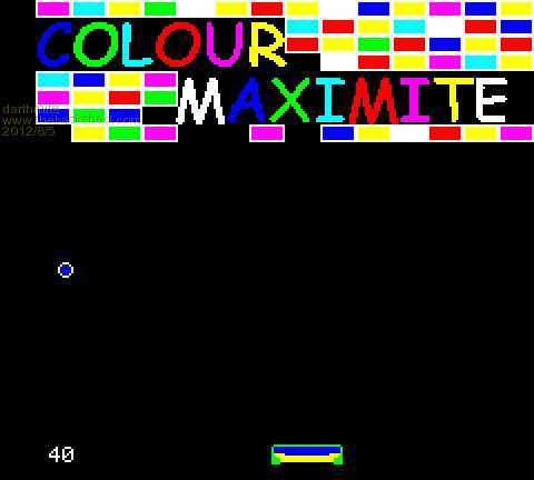

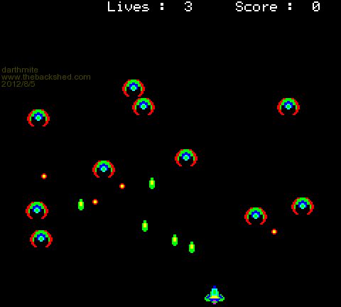

Hi
Before i restart to work and get no more free time i have want made some
other tests with the last MMBasic v4.0 beta 12.
The today tests was a arcade like game ...
And a little Breakout game ...
And to see everything move i made a little video
Arcade / Breakout video
The sources codes :
2012-08-05_180002_sources.zip
With all demo's in this thread you will have enough examples to start with
the new ColourMM
Cheers.
Darth.

Nick
Joined: 09/06/2011
Posts: 512
Posted: 10:02am 05 Aug 2012
Very good darthmite. These programs you are producing show others what the new Colour Maximite and MMBasic is capable of.
The important thing to stress to everyone, especially those from outside of the Maximite camp is that alll these demo's are written in simple-to-use *Interpretive BASIC*, no compilation, no C or assembly code but B A S I C.
These new graphics commands can be used for more than games.
A program to monitor external events via the interface connector (analogue or digital) could be created that loads the screen display with all necessary data readouts such as a graph as shown below.
The entire pre-drawn screen would load using a single command.. LOADBMP"READOUTS.BMP"
The program would read the data coming in from the selected port and a pixel plotted on the rightmost side of the inner blue grid window. The movement of this data can be moved vertically by continuously plotting a pixel in that vertical axis in Green.
Using the BLIT command, the content of the Blue grid window can be moved left within the boundaries of the window with a command such as BLIT 11,10,10,10,99,100,G
I'm assuming here that the window occupies the coordinates 10,10 for a width of 100 and a length of 100.
The G at the end tells it to only move the data on the Green bitplane. This therefore moves the Green pixel to the left leaving the blue grid below untouched.
It's quite possible to make something such as this with just a few lines of MMBASIC code, maybe even on a single line if you use multi-statement lines. And all created directly on the Maximite itself, your fingers never need touch a PC or MAC!
It also means you could have more than one of these data readouts on a single screen monitoring several inputs at a time and all being scrolled simultenously on the screen.
Ah! My Colour Maximite can't get here soon enough.
