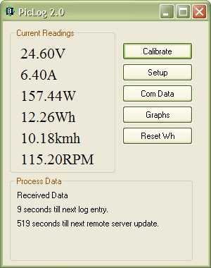

The PicLog version 2 is coming together nicely.
I've added a reset Wh button. Clicking this will open a small window to let you reset the watt hours to any number you want, 0 by default. The new PicLog will also remember the Wh figure if you accidentially close/crash the PicLog program. When the program is started, it looks for log files for that day, and if it finds one, the last Wh entry becomes the new Wh reading instead of 0.
Just BASIC communicates with the Windows API very well for a simple language. One problem I heard about with the old PicLog is lack of support of com port numbers over 8, a limitation of VB6. Just BASIC will support any com port number, my running copy of PicLog 2 is currently using com port 20.
I still havn't started on the graphing, thats next.

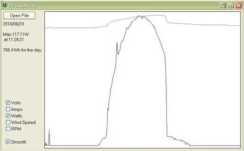

I've started on the graphing program. It will run as a separate program to the PicLog, and this is how I think we should develope the PicLog in future, as separate modules/programmes. The PicLog program connects to the hardware and logs the data, a separate program called PicGraph will display the data. Later I'll write another module to display the live data as analogue screens, like Windman did with his PicLog. All the individual programs can be running at the same time.
This is a screen shot of PicGraph, as you can see, early days. You'll notice the Smoothing option, this cleans up the display if your logging at a high speed.
