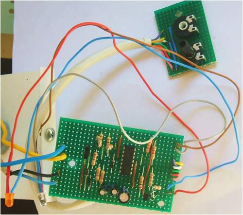

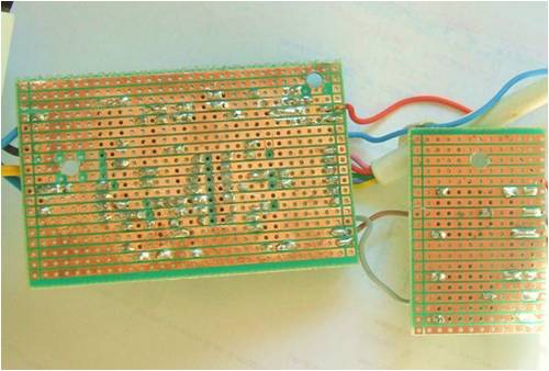

Here are the photos at last.
I have changed the resistors as suggested but no difference. The relay still trips out when the voltage is changed not when the low volt pot is altered. I have reached my limit of knowledge. Is there anyone prepared to make me one? I will obviously pay costs, postage etc. It is now becoming quite urgent. Help would be greatly appreciated.

Posted: 08:07pm 10 Jul 2010
I cant see what the purple and pink wire is connected to from the trimpots on the main board.
Looks like you have cut the track but not connected any thing to them.
Pete.Edited by Downwind 2010-07-12

Posted: 08:17pm 10 Jul 2010
The 2 outside wires are from the outside terminals of the pots. They were soldered on before I realised they weren't needed. I presume the pots are OK. I miss ordered. In this part of the world I have to buy from Britain or America. There are places here but it is still cheaper to buy from abroad. The only other thing I can think of is that the op-amp was shorted and is soldered directly to the board. Could this have been damaged? The large yellow and blue wires go to the relay, the finer blue and black are the power.
As far as manufacture, all I need is the board. I have a box for it.

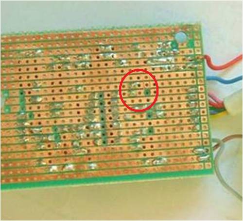

Working through the pin voltages you posted last i am troubled with pin1 as the voltage dont change so you might have a solder brige on pin 1 or a damaged chip.
Retest the voltage on pin 1 as you adjust the voltage it should switch from about 1.5 volt to about 7 volts........there is a problem there.
pete.
Posted: 08:56pm 10 Jul 2010
I think you might find a copper bur next to the jumper off pin1 where you cut the track.
Your problem lies around pin 1 look very carefully you will find a bridge or short there some where.
Look Here

Posted: 09:23pm 10 Jul 2010
OK one by one!!
The pots are 10k and will switch the power on and off so I presume they are Ok
There are no solder bridges anywhere. I have scored between the strips with both a steel dental pick and a broken hacksaw blade and finally brushed it down with an old toothbrush.
I think the op-amp is damaged and will replace it and use a "plug" this time so it's not soldered.
