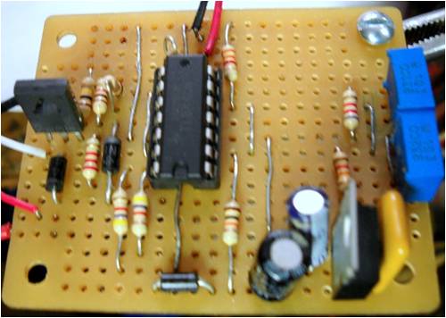

Here is the pics and pin out of my latest board; this isn't a vero board.
Bob
Posted: 03:28am 15 Feb 2010
Good work Bob,
I notice you have also used a 10K resistor for R1. My circuit would not work with a 12K as R1 and i needed a 10K.
Have you tried the circuit with a 12K as R1.
I thought it might have been that i was using 9v reg. that i needed the lower value for R1.
I am wondering if Georges circuit will work if he changes R1 to 10K......worth a try.
Bob could you do a voltage pin test at 15v or the dump on voltage you have set.
Pete.

Posted: 03:44am 15 Feb 2010
I haven't tried it with a 12K yet, maybe on the next one.
I'll try to get a 15 volt pin out before I put it in the case. I've got the dump on set at about 14.7 off at 13.0 on my Fluke 8025; but I can bump my hp 0 to 30 supply up to 15.0 with the fine adjust no problem.
Take me longer to do the graphics than the test.
Bob

George
Joined: 07/02/2010
Posts: 8
Posted: 06:38pm 16 Feb 2010
Pete & Glenn,
I've been watching the forum, and the new board is together, I just haven't posted the pics or tested it yet. I'll be switching R1 tomorrow when I get a few minutes. This time around it looks more professional. I'm glad to see all this discussion and some minor corrections and clarifications regarding the project. I think the end result of all this will be a project that is much easier to understand and build, making it a better asset to the site.
George

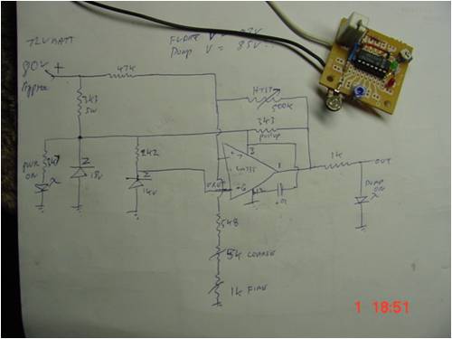

Adonis, here is a discussion using the 339 as a dump controller. It is simpler than Glens circuit, and was simply to demonstrate the simplest controller for 12v to 100v. (change zener for 12v)
It uses a positive feedback resistor in the style that Gordon referred to to give hysterisis range. It has two pots.... not for high and low, just for high cut in, the hysterisis takes care of cut out, the second one is to fine tune the voltage cutin point... ie course and fine for the wide range it operates over.
I also discuss the use of 339 chips, and the pull up resistor problem.
The original circuit from Methanolcat was using the 339 without the pull up, and thats why the discussion ensued.... how to get hysterisis in the circuit. It used 4 stages of dump voltages, so needed a single op-amp solution, or it would have been unweildly needing 4 for each stage (Glens).
There is a third pot for demonstration purposes to set hysterisis.
This one is probably the most useful, the others were discussion circuits.
