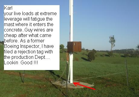

Are there any guy wires on the tower?

Nope, no guy wires whatsoever and shes pretty solid to boot.
Had to be cow proof and short of fencing off 1/2 an acre for the guy ropes this was the only way.
Cost is similar but we are a couple of metres shorter than a similarly priced guyed tower.
The 3m3 of concrete was almost $500 and the pole (which is crap BTW) is a total of 6.75m tall $840 made of 5" Bore casing 5.65m bottom section and top section about 3.5m with an overlap of ~900mm plus the mount ontop for the turbine to sit in.
Now for the next trip, safety system testing, will give the batts and mill a little belting, turn off the GTI, test dump 1 followed by pulling the fuse on the dump 1 to test dump 2, i'm thinking at 800W (have max 1600W in 400W increments) load for dump 2 (normaly both dumps will work together) should give it enough load (given isolated from the batts) to slow her down lots or grind her to a halt.Edited by KarlJ 2010-02-20

Greenbelt
Joined: 11/01/2009
Posts: 566
Posted: 04:08am 19 Feb 2010
KarlJ
Joined: 19/05/2008
Posts: 1178
Posted: 04:36am 19 Feb 2010
Thats why I bought it from eastcoast green energy.
They reckon she's engineer certified with upto 2KW mill ontop.
With supporting engineering I must assume he's calculated for a decent life.
I do agree that the loads there would be decent, call it 60KG load at distance of 6.6m =3880nm of torque being applied here, that said, 5" bore casing is HEAVY stuff though being mild steel will deal with fatigue well.
To be honest I'm more worried about the welded joint half way up the top mast, it has the welded on triangles for support but the welding is woeful quality.
BTW now seen over 700W and we're only on day two!
12.5A at 57V
BTW Greenbelt are you taking the piss being a Boeing Inspector? I used to do that!Edited by KarlJ 2010-02-20

My first tower was like that one pictured and it was installed right next to my shed which is only a 1/3rd of the way up the hill. One morning I looked up to the shed to see the top section of the tower bent about 45 degrees. It was 2" rural grade water pipe too. As other guys have said get some guys on there quickly just below the blades or be prepared to show the pic's of the bent tower....

if you want a split collar with some eyes for guys give me a ring.I just need to know OD of pipe.You could tether them to the pig tails.Might help with suspect weld on pipe.

I have faith in the engineering behind it.

Greenbelt
Joined: 11/01/2009
Posts: 566
Posted: 11:23am 19 Feb 2010
KARLJ,
Sorry Mate That's how it is in oz land,Take some and surrender some, but always share the Beer.
I have a new picture of the folks down under after a google search for (piss take) I arrived at this conclusion,,
I am Guilty as Charged, The desire for attention drives me to a continent half a world away and a willingness to deal with a country wide epidemic of mental illness.
1968 Boeing Everett, Washington, Largest single building in the world Nearly completed. The Mockup of the 747 jumbo jet airliner was transported from Renton Wa. to the new building this is where I worked until a lay off in 72
bad year here in the states. I and some friends stopped by the Boeing Museum of flight about two years ago to view the original
piece of work. I pointed out a 1"dia. round patch in the skin of this aircraft that began as a 1/4" rivet hole drilled in the wrong place. odd that I remembered after all those years,but maybe not, It took engineering 3 weeks to decide how to fix this hole that had been worked on repeatedly by the riveter, they were fearful that the hole would be a starting point for skin cracks at altitude cabin pressure. this plane was never used by an air carrier. it was used to certify the model and in "Air shows" for promotional purposes. It had its own name,
"CITY OF EVERETT"
A Google search will turn up Info for those interested.
Over 1 hp already. Did you get a wind speed at that time
and do you have a tac. on the rotor yet? would be interesting to find the torque those blades are producing.
Karl , The preceding post was Meant to be a heads up
that could possibly save your mill. 120 pounds jerking and thumping around with gyro forces many many times in the course of a year will harden the steel until it becomes brittle and then break like glass, should keep the flexing at minimum near the base. Stop by for a Beer and we'll talk about the rejection tag.
. EDIT; I had not read your latest post Good luck in Perth.Edited by Greenbelt 2010-02-20
