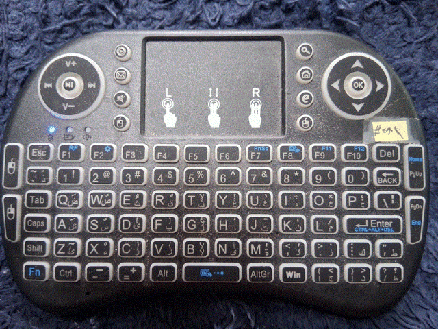

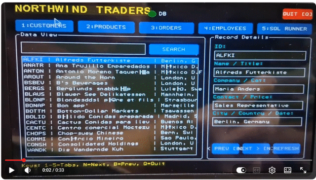

Meanwhile, it's hard to keep up, but I'm trying to be a fast follower. Gemini  Antigravity CLI 1.1.5 with a Pro monthly subscription running in Windows PowerShell built this in about an hour, talking directly to the PicoCom3 over Com4.
Youtube Northwinds
I plugged in the usb RF module from this to get mouse and keyboard:
Edited 2026-07-24 05:02 by lizby
