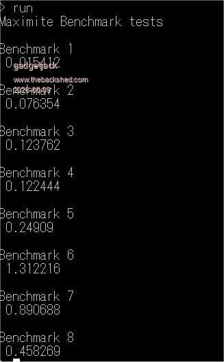

Here is the benchmark speed test for the esp32-s3 version of basic.
I am happy to get some use out of those boards that were wasting time in my bench drawer.

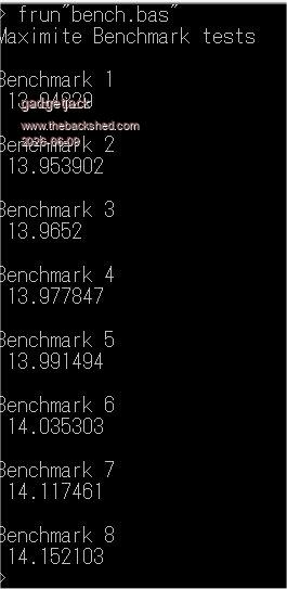

Ok , I used [frun] on the bench test i posted before. pretty big change....
Jack
gadgetjack
Joined: 15/07/2016
Posts: 240
Posted: 10:40pm 08 Jun 2026
I did have to change all " if " statements to " if then " before it would compile right. Other than that , no worries.

gadgetjack
Joined: 15/07/2016
Posts: 240
Posted: 12:06am 09 Jun 2026
Benchmark.zip
 This is the file we have passed around for a while to test the pico speed. When i tried it in "frun" it came back with "if without then" error. I added a then to each line and then it was fine. That was the only error it gave me , rest ran ok and faster.
Jack

Posted: 01:32am 09 Jun 2026
  gadgetjack said  Benchmark.zip
Jack
Yeah 'frun' is it's own parser, so rare syntax forms sometimes get missed. I'll post a fix for this soon.
It's about 10x faster than the interpreter on this benchmark.
