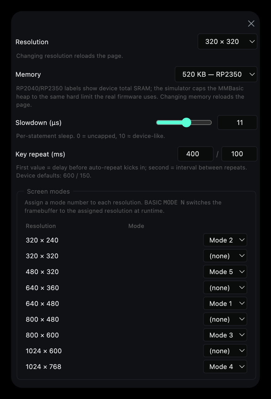

Changing the screen size reboots the simulator. The mode command will change screen size without a reboot. The config menu allows you to map modes to resolutions.

Is it possible to set additional modes? For example, the RP2 HDMI supports several modes at 320x240 and 640x480, just with a different bit depth
'no comment
The mode mapping is in the config
It doesn't really address bit depth, and I am don't remember what bit depth the simulated framebuffer is, but I think it's high, 16 or 24 bits.

  Quote  It doesn't really address bit depth, and I am don't remember what bit depth the simulated framebuffer is, but I think it's high, 16 or 24 bits.
Yes, I realise that, I may have expressed myself badly..
I was thinking of a way to choose between several modes for a given resolution
'no comment
