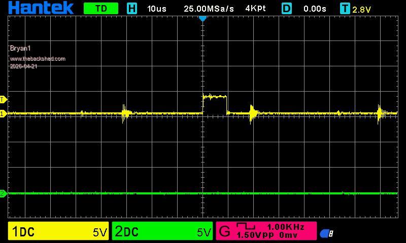

YAY got finally got the DM556 working       thought I would try putting the wires to ground as in the grey moments had them pulled up and saw the dial indicator move
So now off to Ebay to buy 3 new DM556's for the surface grinder and man we have lift off........
Edit: just noticed I had the 5 volt pull up in the hole beside the 4.7K resistor and while doing a run the scope did confirm it is running on 3V3
Here is a scope pic of it running
Edited 2026-04-21 13:19 by Bryan1

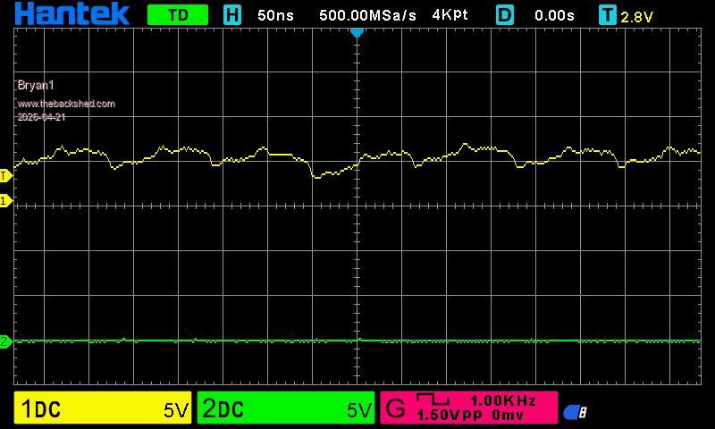

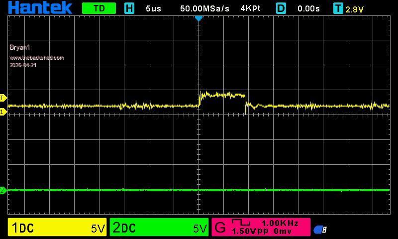

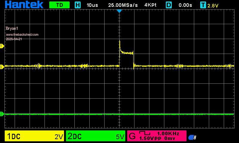

Now having a bit of play with this and one thing I found where I have set in Mach3 282 step/min which is accurate to a thou   going 1100 steps with the code only goes 0.95mm, now as there is a nice spike when it goes high I set the scope to 2 volts to capture it
Now I have used the 5 volts on the cnc board for the pullup on the collectors and the probe for Channel 1 is on the collector for the step pin yet it clearly shows a lower voltage for the step trace.
On reading the Stepper PDF I enable the Scurve thinking it smooth that spike and no matter what I set the Stepper Jerk value I get the error it is too low even when I set to the step/mil figure so a bit to learn with this command.

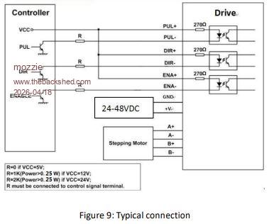

Posts: 3416
Posted: 04:33am 21 Apr 2026
See the circuit diagram in Lyle's post at the top of this page. It shows the 3 input (+) terminals connected to Vcc.
Make sure they are connected to 5V, not 3.3V.

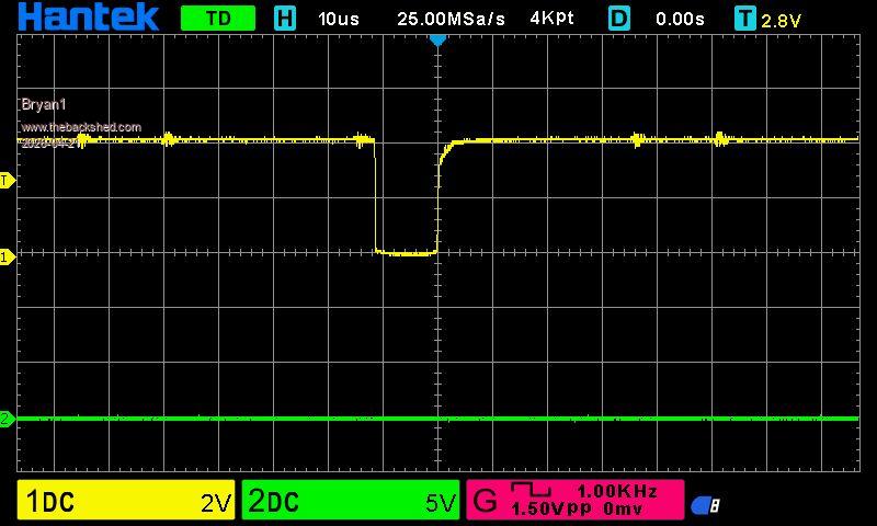

So it looks like the transistors should be wired to invert the signals.
10kΩ from Pico pin to base, emitter to ground and collector to input (-).
All input (+) to 5V. Pullup resistors not needed.
With the scope connected between input(-) and Gnd. you should see inverted pulses going from about 4.5V to 0V
Edited 2026-04-21 14:58 by phil99
Bryan1
Joined: 22/02/2006
Posts: 2297
Posted: 05:33am 21 Apr 2026
Ok just did the change Phil and looks like for once I got it right
