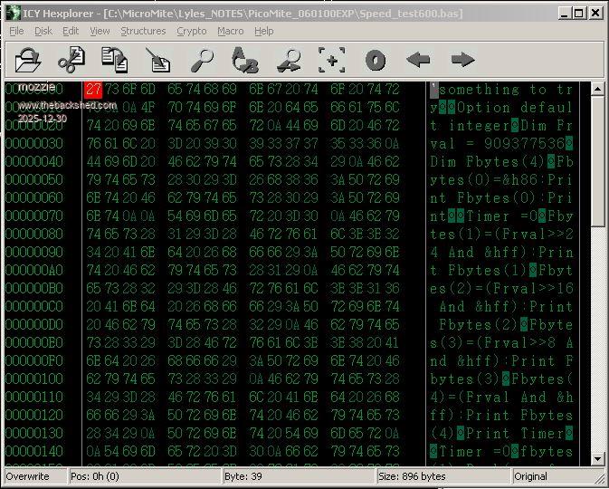

During testing of V6.01.00 and V6.01.00EXP2 using TeraTerm and Xmodem a problem has come to light, this is with xmodem s and xmodem s "filename.bas"
The internal editor and Xmodem r appear to be working fine.
Tried: (with Clear_Flash before each upload)
PicoMite RP2040 V6.01.00
PicoMite RP2350 V6.01.00
PicoMite RP2040 V6.01.00EXP2
PicoMite RP2040 V6.00.03 - working fine
The line ending characters are being removed from the file during transfer and being replaced by &h0A
Also +++++++++++++ being added to end of file
> option list
PicoMite MMBasic RP2040 V6.01.00
OPTION COLOURCODE ON
OPTION CPUSPEED (KHz) 200000
OPTION LCDPANEL CONSOLE ,,,, 50,NOSCROLL
OPTION DISPLAY 26, 60
OPTION LCDPANEL ILI9488, RLANDSCAPE,GP14,GP13,GP12,GP20
OPTION LCD BACKLIGHT 50
Also tried with OPTION LCDPANEL NOCONSOLE with same result
Can anyone else please confirm?
Lyle.
Update:
Xmodem s - removes &h0D but not &h0A from line endings
Xmodem s "filename" - line endings ok
Both add &h1A as padding characters to end of file.
Edited 2025-12-30 04:01 by mozzie
Posted: 06:46pm 29 Dec 2025
Xmodem traditionally padded files to a multiple of 128 bytes using &h1a (0x1a, ctrl-z).
I think due to being on CP/M, with its block size of 128.
Posts: 12057
Posted: 07:32pm 29 Dec 2025
  Quote  Can anyone else please confirm?
No: works perfectly for me. Just the end of the file padded with &H1A which is correct.
Is that your full option list? If so you should always configure touch if the display has it otherwise bad things can happen - floating CS for the touch chip
Posts: 6626
Posted: 07:33pm 29 Dec 2025
XMODEM S without a file name sends a listing of the current file. MMBasic is probably listing with <LF> as the line ending. This is not a problem. MMBasic is happy with either <CR><LF> or <LF>
The padding ctrl-Z is from the CP/M days but zeros are also acceptable.
XMODEM requires a full packet of 128 bytes and may send a complete block of all crtl-Z if the file size happens to be a multiple of 128 bytes.
This has worked well for 40 years...
