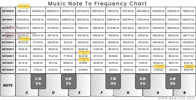

Next, I'll adjust the frequencies according to the great link from Volhout (C5, D, E, F, F#, G, A, B, C6, D, E, F) - let's see how it sounds then...

NPHighview is absolutely right! A simple C major is not enough.
Yesterday, I tried the following frequencies:
C5  523.3
D5  587.3
E5  659.3
F5  698.5
F#5 740
G5  784
A5  880
B5  987.8
C6  1046.5
D6  1147.61
E6  1318.5
F6  1397
Michael, your frequency is there too! A big THANK YOU to Volhout - I got the frequencies from your GitHub link. It sounds very much better, but it's still not quite right! Something seems to be wrong, especially with the higher notes...

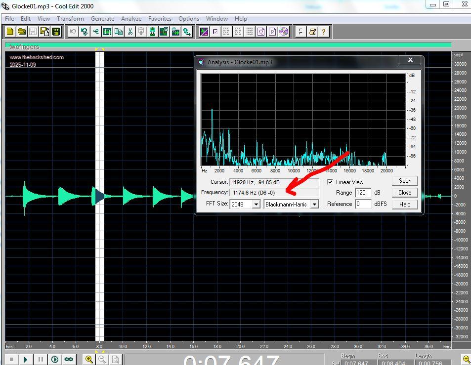

This means that, for example, for Play Array you only need one frequency to play an octave. For example, by changing the factor. It seems important to me to adjust the volume simultaneously. An example from my test program:
Dim float ii=1
Dim integer mvol=28
 Print ii,ii*Freq1a/Pi2
 Play volume mvol,mvol
 Play array packed%(),packed%(),Play_Freq*ii
 Do :Loop Until MM.Info(sound)="OFF"
 ii = ii * 2^(1/12)
 Inc mvol,4
Loop Until ii >2.68
Do :Loop While Inkey$=""
Glocke01.zip
Regarding the determination of the frequencies (my idea on the subject):
As already mentioned at the beginning of this thread, I would have sampled the bell tones - e.g., with a smartphone - and converted them to mp3. Then I would have had an audio editor program analyze them (FFT analysis). This is quite easy with bell tones, as they have a typical waveform.
Michael

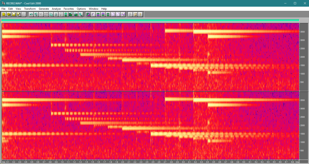

If I manage to create an MP3 file of the bells tomorrow, would you help me analyze it?
I tried it yesterday with a microphone and my oscilloscope. The result could be correct for the higher bells. However, the lower the bells become, the more difficult it was to read anything from the curves.

Frank,
This is how I would approach it.
There are only 12 bells, so there are 12 different frequencies (tones) and thus notes.
The bells will not be "calibrated" (it is a toy), but should come close to 12 different frequecies in this table.
Sound 1 bell (short short ULN2003 output to GND).
on any musical instrument, find the note it resembles.
-or-
in the pico: OPTION AUDIO gpx,gpy
with a 220 ohm series resistor from gpx, and after that a 100nF to ground, connect to a headset/speaker/amplifier.
PLAY TONE 1175,1175
(to test for a D note in octave 6).
Find the note is resembles by trying different frequencies.
Repeat this for every bell, and you have the translation table (both frequency, and note).
With a bit of effort you are done in 30 minutes. You can also write a program that scans through all the frequencies in above overview so you can use up and down keys to the next value. That works even faster. But you need to write a program.
These bells are small, so I expect the frequencies to be in octave 5,6,7. Don't worry about the lower octaves.
Edited 2025-11-12 22:29 by Volhout

@Volout:
Thank you very much for your table. That's my plan "B"!
@twofingers:
Michael, I have recorded 3 WAV files and attached them.
REC000.WAV.zip
Thanks so much to both of you!
Frank
Posts: 6626
Posted: 09:12pm 12 Nov 2025
Time in seconds and frequency in Hz.
I would draw gridlines for frequency to make reading the frequency easier.
Thats a start
Edited 2025-11-13 07:15 by TassyJim
