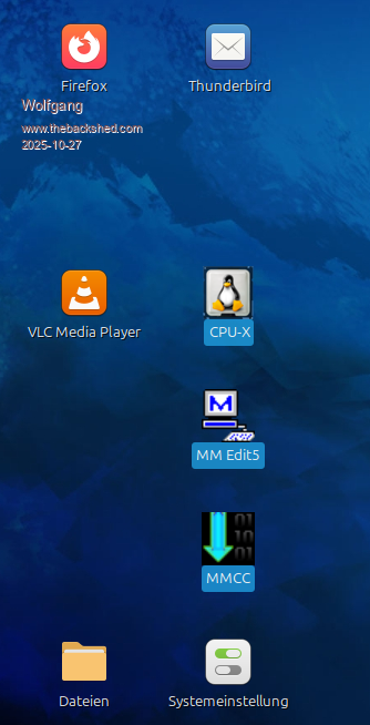

basically I wanted to say goodbye to Windows and have made MMedit accessible on Linux Mint with an icon from the desktop.
I wrote a small routine with Linux MMedit to test it, but I can't manage to set the correct port to start the program with MMbasic
In MMedit I only see COM-ports from 0 -31, but none of them have an ending that indicates the connected USB port.
The Test-program fully works under Windows.
And Perplexity delivers no solution, can you help?

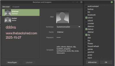

  TassyJim said
  Quote  If you have the 22.4 kernel, you may need to run this:
sudo apt-get install qtbase5-dev
@Wolfgang
The Qt libraries are essential. The above command must execute without error.
And in order to be able to connect to a PicoMite your username must be in the group "Dialout".
Go to "users and groups" in your system management folder and add your username to Dialout:
Edited 2025-10-27 07:50 by dddns

@Tassy-Jim
Based on your excellent explanations concerning the MMedit background, I will now try MMedit with mmedit5_20.4.tar.gz, as I am having problems with the serial port using MMedit under Wine. The last was not my intention, and I didn't know that before.
@dddns
In retrospect, I see your suggestion as completely correct. It is exactly what I now see clearly explained by Tassy-Jim.
Your further suggestion to involve the dialogue-group was new to me. Thank you very much for that too.

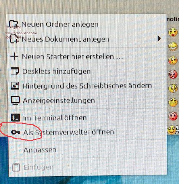

Due to my attempts to start MMedit without WINE, I have locked myself out of Linux Mint. I can no longer activate Timeshift or activate Users and Groups.
When I request root privileges, the terminal tells me that I do not have root privileges.
Even powering off and restarting does not give me access to Timeshift, on whose hard drive I had previously stored backups.
Do I have to completely reinstall my Linux Mint?
Can you help?

How are you asking for root? There are various ways to use sudo.
See if
man sudo
brings up anything useful.

Posted: 05:14pm 27 Oct 2025
Thank you for pointing that out, it was new to me.
As a complete novice with Linux, I feel slightly overwhelmed by getting down into the depths of Linux.
I have already used passwd etc., but the lock symbol won't disappear.

The root account is "disabled" by default in modern distributions.
You setup the machine with your username and this is the first username which will be in the group "sudoers". AFAIK "sudo" means "superuser do" and superuser is the root account.
If a second user is setup on your machine, then you the administrator need to add the second useraccount to the group "sudoers" in order to allow system near changes like installing a program or using the serial port..
The root account itself is normally never used. I think it's common opinion in the community to give root a password because of security reasons. But not for usage in first sight. It can be important in case something "happens" to your useraccount like you cannot login anymore.
So your password is needed when the system asks you for "Administrator password"

After Power up the system asked me every time before for the admin-Password. But now the system is in a mode trapped, where it don't ask me for the Admin-password after Power up. I can work with Linux as usual and any limits, except I want to use Timeshift or "Users and Groups".
At the moment I don't know what to do. All the advices of the AI's didn't help .
