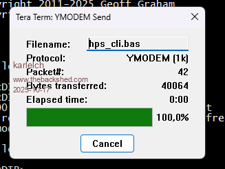

Hi Peter,
including YMODEM is a great idea!
I tested it today but discovered a bug. I nuked the Pico 2 (2350A) and installed the latest default firmware (RC3, no options set). Then I entered
ymodem receive
and in TeraTerm (v5.2; Windows 11) I started file/transfer/ymodem/send and selected a file on my PC. TeraTerm indicated a transfer but then it stopped at 100% and nothing happens.
After a while, the dialog closes, the Pico remains responsive, but the file is not on the Pico.
The coding in TeraTerm is English/ISO8859-1. I tried UFT-8 but this also did not work (less even, as there was no progress in the file transfer).
ymodem send
is also not working.
> option list
PicoMite MMBasic RP2350A V6.01.00RC3
OPTION FLASH SIZE 4194304
OPTION COLOURCODE ON
OPTION CPUSPEED (KHz) 150000
Any advice?

Posts: 3416
Posted: 12:31am 17 Oct 2025
Ymodem tests.
RP2350A VGA mode 3, TeraTerm 5.2 using Pico VCP
Pico prog. mem. to PC - OK
Pico file$ to PC - no transfer
Pico "a:file" to PC - no transfer
Pico "b:file" to PC - no transfer
PC file$ to Pico prog. mem. - OK
PC file$ to Pico "a:file.ext" - OK
PC file$ to Pico with drive a: active, Y modem receive "file.ext" - no transfer
PC file$ to Pico "b:file.ext" - OK
Xmodem test.
Edited 2025-10-17 10:36 by phil99

Posted: 06:09am 18 Oct 2025
  phil99 said  Xmodem test.
Same here.
With YMODEM, nothing works for me.
P.S. "2025-10-11_021652_PicoMiteV6.01.00RC0.zip" was the last version XMODEM worked fine.
Edited 2025-10-18 16:17 by karlelch

I have cannot test YMODEM thoroughly right now, but one observation: The following code transfers the file (using TeraTerm) but hangs in the dialog at 100% for a while until it closes. The Pico is responsive but the ">" appears only after the next command. Same result with higher CPU speeds.
> option list
PicoMite MMBasic RP2350A V6.01.00RC4
OPTION CPUSPEED (KHz) 200000
> ymodem receive "hps_cli.bas"
> files
A:/
  <DIR>  .
  <DIR>  ..
00:00 01-01-2024          4  bootcount
00:00 01-01-2024      40064  hps_cli.bas
2 directories, 2 files, 1929216 bytes free
YMODEM SEND "filename" works flawlessly.
