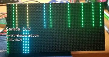

I downloaded the version you posted on Oct 20th (TwoSmMorph.bas).  When I run it all I get is a series of vertical lines.  Please see the following.    I ran the code on a PR2040 and a PR2350 with PicoMite MMBasic RP2040 V6.01.00b14 loaded.  I tested it with a P2.5 and a P4 display and got the same results.
I can see your code should run a demo display with text and several graphics, lines etc. However in my setup it does not get to the demo.

Hi Don,
thanks for the answer.
The display looks a little bit confused. Some with the clock- and latch-signal.
Did you notice that the connection has changed?
In preparation for expansion to 64 by 64 pixel, I add the "E"-addressline on GPioPin 10(for the PIO, they must be in line with the others).
In preparation for increase the colordepth, I also change the RGB-Pins, sorry.
I have specified this in the header.

version new "TwoSmMorph.bas"
' gp0  RED0              Connection HUB75
' gp1  GREEN0
' gp2  BLUE0                  +----+
' gp3  RED1              RED0 |1 16| GREEN0
' gp4  GREEN1           BLUE0 |2 15| GND
' gp5  BLUE1             RED1 |3 14| GREEN1
' gp6  A                BLUE1  4 13| E
' gp7  B                    A  5 12| B
' gp8  C                    C |6 11| D
' gp9  D                  CLK |7 10| LATCH
' gp10 E                  /OE |8  9| GND
' gp11 CLK                    +----+
' gp12 LATCH
' gp13 /OE
Could that be the cause?

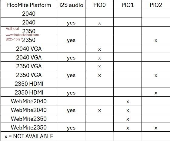

That is why I use PIO1 for most of my projects. It is available on all non-WIFI platforms.

thanks for your answer and for the overview! I remember, that there was one, but I could not find it, even by searching the forum. It is not in the manual, or is it?

Thank you to all who replied, so PIO 1 is not available on the Webmite, i've quickly put the normal picomite firmware on the Pico 2 W and Alberts "TwoSmMorph.zip" runs fine without any errors, so when I get home tonight i'll attach the display and see if it lights up.
I figured it would be good to use the Pico 2W with the Webmite firmware so I could grab the current time and date from a web based NTP server to automatically set the clock?
Presumably Alberts TwoSmMorph.zip code could be modified to use either PIO 0 or PIO 2 instead so I could still utilise the Wifi on the Pico2W?

Hi Albert,
How stupid of ME not to notice the change in the wiring!!!!   I’ll make the change and give this a test as soon as I can.

QTony,
I think all PIOs are equal. It should be no problem to use an other one.
There are only a few parts to change from 1 to 0
"PIO dma tx 1 .."
"PIO CLEAR 1"
"PIO ASSEMBLE 1 .."
"PIO init machine 1 .."
"PIO start 1 .."
"PIO stop 1 .."

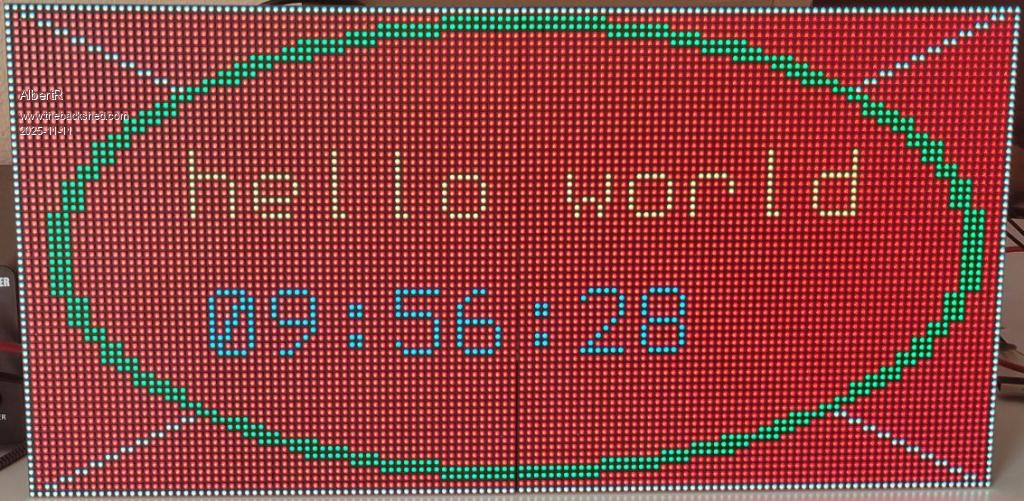

Hi together,
for basic access to the display, here is a minimalist "user display driver"(128x64).
It is not very fast, but it works so far.
It should work for displaying quasi-static information such as time, date, and temperatures. Scrolling text is still a bit jerky.
Now you can use MMBasic commands. Don't forget the DisplayUpdate. If that would be done in the sub, it would be slower.
CLS RGB(red)
DupD()
Color RGB(127,255,127)
Line MM.HRES-1,0,MM.HRES-1,MM.VRES-1
Line 0,MM.VRES-1,MM.HRES-1,MM.VRES-1
Line 0,0,0,MM.VRES-1
Line 0,0,MM.HRES-1,0
Line 0,0,MM.HRES-1,MM.VRES-1
Line 0,MM.VRES-1,MM.HRES-1,0
DupD()'display update
Circle MM.HRES\2,MM.VRES\2,30,2,2,      RGB(0,255,0),RGB(255,0,0)
Text MM.HRES\2-j,MM.VRES\2+8,"hello world",CM,1,1,RGB(255,255,0),RGB(255,0,0)
For i = 0 To 100
 j = Sin(i/15)*15
 Text MM.HRES\2+j,MM.VRES\2-10,Time$,CM,1,1,RGB(0,255,255),RGB(255,0,0)
Next i
End
