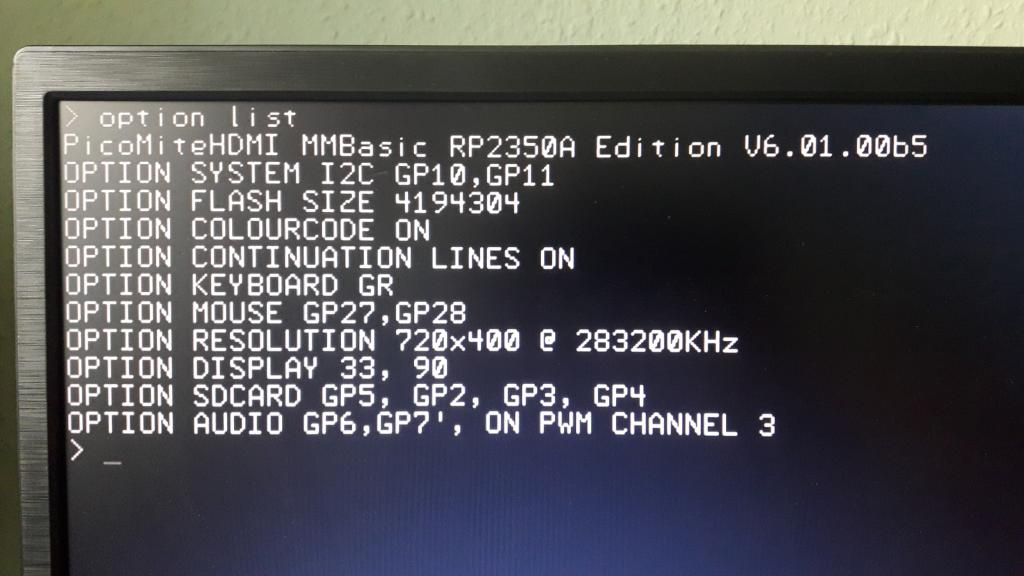

Hello,
I have report a possible bug (a least MMBASIC crashes & reboots) PicoMiteHDMI:
Problem: I have a (bigger) program, which has an image viewer function. The program itself works in general in:
Resolution 720 MODE 3   (to have 16 colours and biggest resolution)
Now, for my image viewer I switch to MODE 4 in program to view the image in 32768 colours.
After some time it crashes and reboots. This occurs after 10 or sometimes after 24 and even after 60 iterations. It crashes with ALL my images (!)
So I made a small test program and it is perfectly reproducable (but as said maybe it takes 60+ iterations, bu often it crashes around ~25...
Here is the program, to be safe, I also packed it with the image (bmp) I used into a *.zip.
'crash in resolution 720p when loading an image
Option Explicit
Dim Integer count=0
 CLS
 MODE 3
 Print @(50,50),count
 Pause 1000
 MODE 4
 Pause 1000
 Load image "mole"
 Pause 1000
 Inc count
My settings:
And the complete zip with program & example image:
crash.zip
Edit: I`ve done some experiments, the Pause doesn't seem to have an influence of he crash, increasing (up to 3000) or decreasing (100) it doesn't change he liklyhood of this crash event. But with my last crash I even manged to do some more harm! Now my pico has done a full reset. All my settings are lost! No a problem. But maybe worth to mention?
Greetings
Daniel
Edited 2025-08-06 19:42 by Amnesie

Posts: 12058
Posted: 08:59am 07 Aug 2025
Daniel
Was able to reproduce, nothing to do with variables, nothing to do with loading images - does it without that statement. The issue is the timing of the mode change relative to the video scan. I've now constrained that and it now works for me (count at 335 and still running)- please test HDMI (non-USB) version attached.
PicoMite.zip
PS thanks for the perfect simple diagnostic program
Edited 2025-08-07 19:06 by matherp
Amnesie
Joined: 30/06/2020
Posts: 763
Posted: 09:47am 07 Aug 2025
Peter!
Ha! I can confirm, it is fixed, wasn' able to crash it again. Rock solid! Great work, now I can preview nice images. Ahhh I love this HDMI version now
