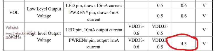

Posts: 9238
Posted: 08:35am 04 Mar 2025
How about a small capacitor across R54? Just to momentarily hold up OVRCUR# ?
PWREN# is active low, the high level output is immaterial. The 4V3 only leaves 0V7 to turn on LED3 and the mosfet. Not going to happen. VOL is 0.6V max at 4mA. With 0.6V there and 1V8 for LED3 you have 2V6 to turn the mosfet on with. That's going to saturate it fast as you have potentially 4mA to charge the gate capacitance, which is smell. Vds should be less than 200mV at 2A under these conditions.
I find it very difficult to believe that this is a mosfet issue. I think it's chip timing.

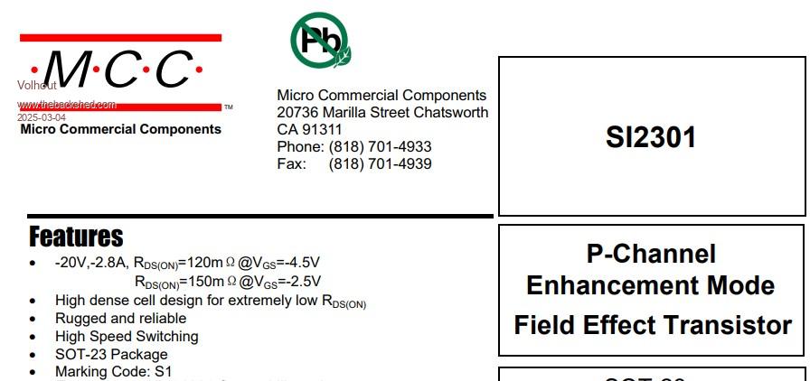

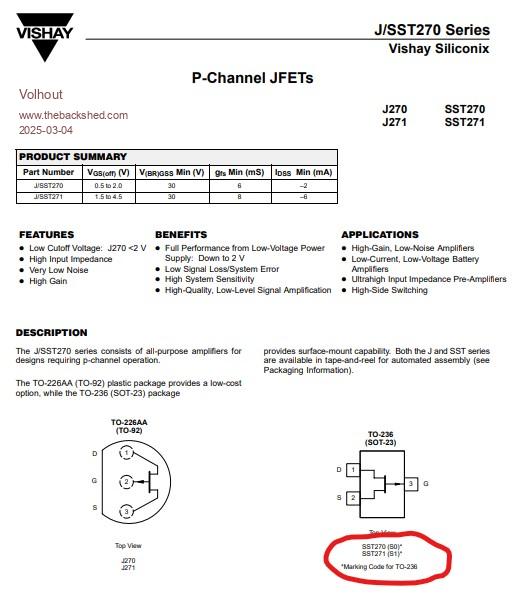

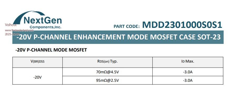

Maybe related, maybe not.
But the "S1" marking fits to a variety of devices.
The envisioned MDD2301 P-FET, or the Si2301 P-FET.
And these have different Rds_on.
MDD2301
But also:
Specified as:
But WORST CASE it is stuffed with a VISHAY J-FET that has also marking S1.
And that will never work !!!
Edited 2025-03-04 19:47 by Volhout

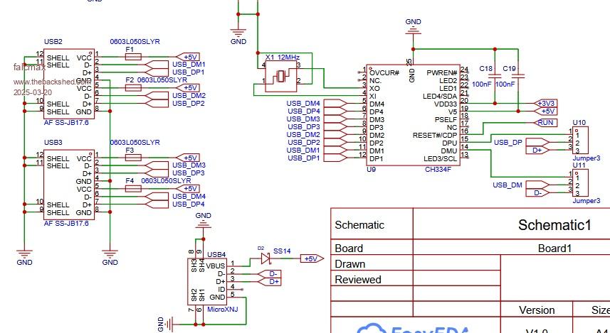

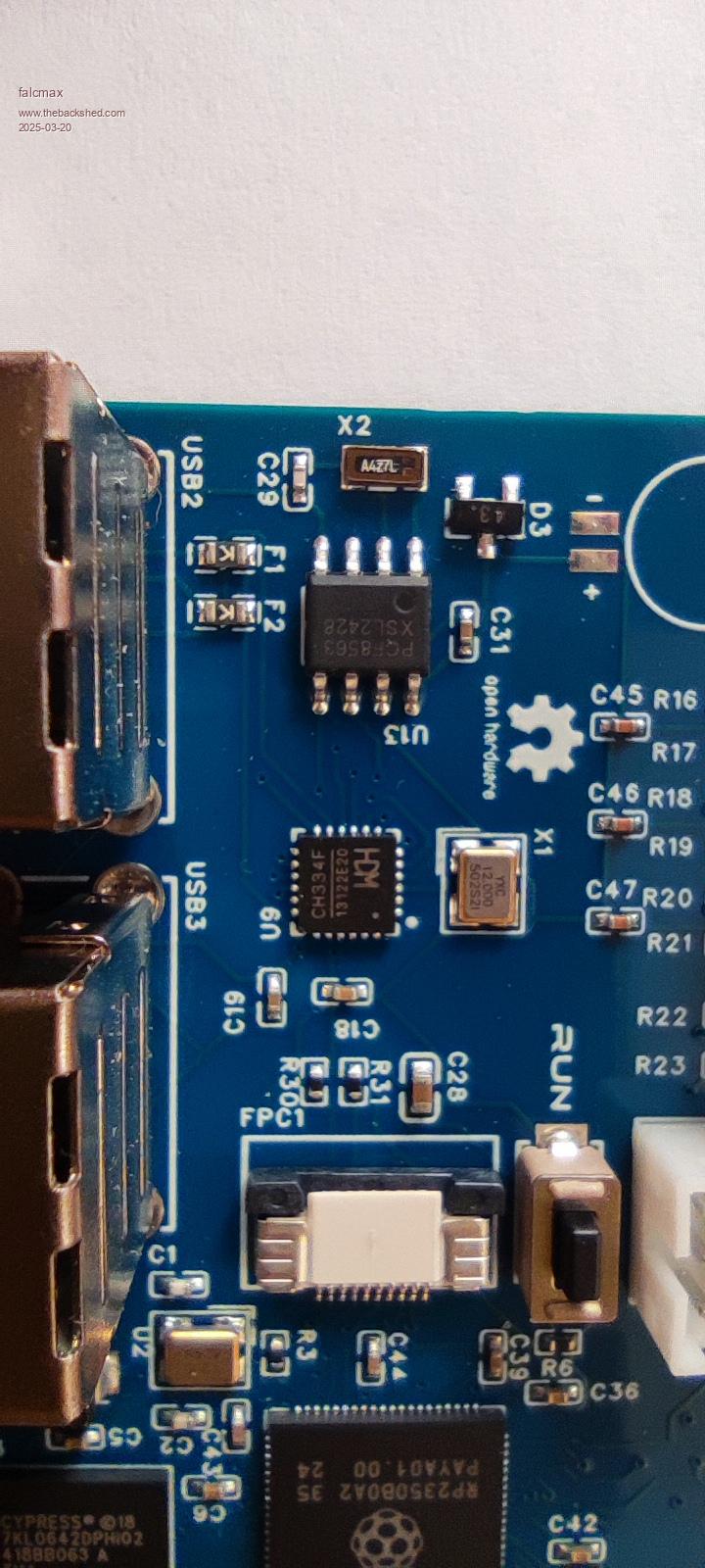

Hi,

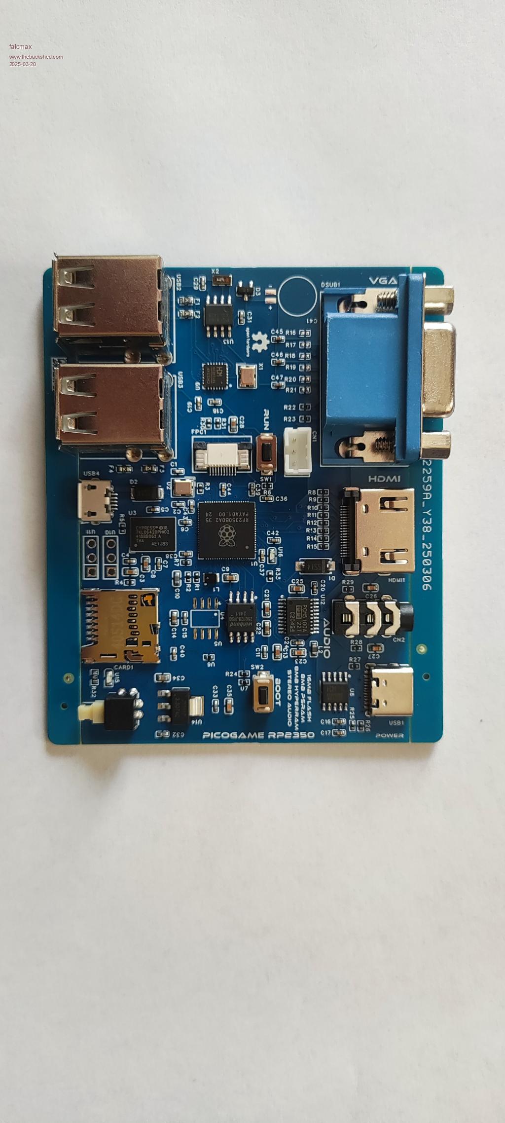

On my board I use the same CH334F chip but without the LEDs and without the PWREN circuit. I placed PTCs on the USB 5V line, and everything works fine. I’m attaching a photo of the chip mounted by JLCPCB.

Why didn't you use the CH334P since you aren't using the LEDs or overcurrent?

8Mbyte DRAM (not PSRAM). Are you using PIO to drive it ?

When I was designing it on JLCPCB, it wasn’t available, but now I’ve seen that they have some in stock. In any case, I have to redesign the board due the wrong assignement of the I2S signals, so may be I will use the CH334P.
