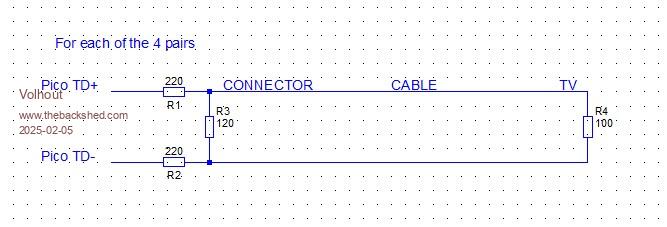

When you are not tired experimenting, there is one thing you could try (I don't have your monitor).
For each of the 4 pairs of data lines onthe HDMI connector, make sure you drive the cable with it's intended differential amplitude (85ohm - 115 ohm).
This can be achieved as in below drawing.
In essence you add a resistor (120 ohm), and replace the 270 ohm resistors with 220 ohm.
This change still drives the differential pair with 560mVpp. The minimum for HDMI is 150mVpp, so still lots of margin.
Another issue with that monitor could be that the common mode voltage of the pico is too high (with resistors this is 1.65V (3.3V/2)). If that is the case you need to add more components, but the HDMI spec says that 3V common mode is allowed. But maybe this changed in HDMI 2.0 (don't have the standard).
P.S. another thing important is clock jitter. The HMDI signal has clock embedded in the data (there is no separate clock). The HSTX clock that drives the HSTX block must be jitter free.
If you look at PIO, the PIO clock can be programmed to any value. But when your ARM is running 100MHz, and the PIO is programmed to do 99MHz, the frequency of 99MHz is made by running 99 clock cycles of 100MHz, and then skipping 1 cycle. So the clock is not constant. To get a constant clock, the PIO clock must be an integer division of the ARM clock. So 100MHz is fine, 50MHz is fine, 33.33333MHz is fine, 25 MHz is fine.  I think this has been taken care of in the SDK (the hard CPUCPEED relation with HDMI resolution), but it is something to be aware of.
Edited 2025-02-05 21:07 by Volhout

Each data/clock loop on HDMI is intended to be 100R. As they are differential outputs from the Pico that puts a load of 100R between GPIO pins, drawing 33mA. That doesn't sound too bad, but there are also biasing resistors that hold each pin at mid voltage under normal conditions and they also have to be overcome. I don't think the value of these is specified but I'd bet on 10K or so.
The maximum combined total current for all GPIO pins is 100mA. Obviously, driving four loops at 33mA each is far too much so the current in each loop has to be limited. That means that the voltage across the 100R load in the display has to be reduced and will always be below spec. Due to the internal resistance of the GPIO pins you won't get drive currents as high as those discussed here anyway! The following is hypothetical.
Using 270R resistors in the data lines reduces the loop current to about 6mA per loop. The input voltage at the monitor has now dropped from 5V (specification is for 4.3 to 5.3V - you can't officially drive HDMI at 3V3) to 0.6V into 100R. This must surely be marginal. Reducing the resistors to 220R increases the loop current to 7.5mA and the input voltage to 0.75V, which must be an improvement.
We are lucky to get DVI/HDMI to work at all.

EDIT: and they drive current (source), into 50 ohm pullups (sink). So common mode is 3V. The 120 ohm resitor may not work.
Edited 2025-02-05 21:24 by Volhout

I thought they were differential 100R inputs centred at 2V5? I didn't see anything about them being 50R pullups...  Mind you, I couldn't find much technical info on HDMI at all!
EDIT:
Ah, I think I've found it now. Each signal line has a 50R pullup to 3V3, so each differential pair *appears* as a 100R loop. Ideally this is driven by open-collector/drain outputs from the transmitter.
This makes life even more interesting. Minimum voltage swing is 150mV and maximum 800mV across that 50R, I assume, so a minimum current of 3mA and a maximum of 16mA.
220R from the Pico should give about 12-13mA, and 270R about 9mA, I think. That's well within spec.
Panic over. :)

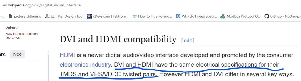

an interesting discussion     just a note of warning - while we are using HDMI sockets at each end and HDMI cabling in between, the signalling standards are 100% DVI. we should be ignoring what the HDMI specifications say, and following just the DVI specifications.
almost certainly, once a monitor realizes that the video signal coming in is DVI it will adapt the input circuitry to specifically suit the DVI specifications.

As far as I can tell the differences between DVI-D and HDMI, although significant, don't really apply here. As far as the hardware goes the plug is the main difference! HDMI has additional capabilities but they are mostly in the software layer (e.g. DVI doesn't support HDCP encryption or audio).

DVI and HDMI are identical in the physical layer. But DVI transports RGB data, and HDMI transports YCrCb data. That is where they differ. Hence the monitor needs to know it is DVI data and not HDMI data.
Edited 2025-02-05 22:47 by Volhout
