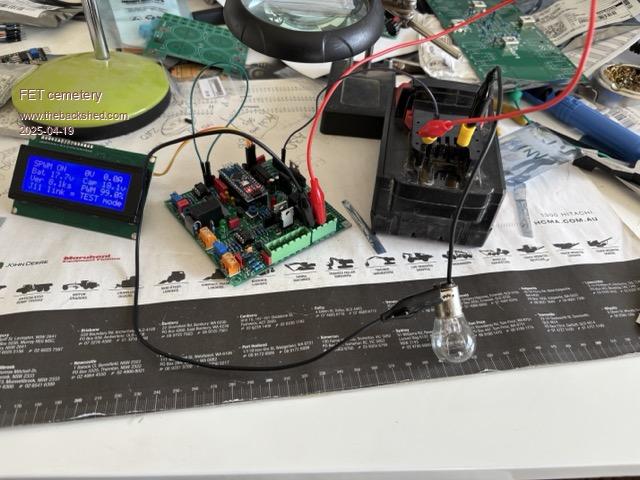

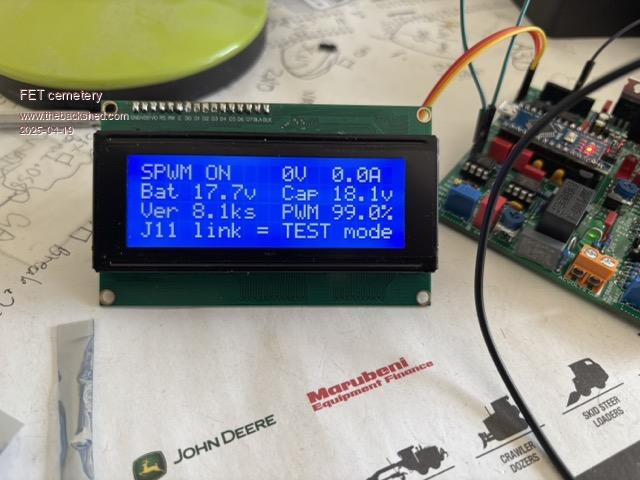

Some progress, things are looking promising:
I have 2 boards completed to this stage and the power fet boards are well underway.

The boards are really nice and usually work first go if you are not burning the candle at both ends when building them, which I have done on occasion. I've built a lot of early version boards as Wiseguy perfected his design and more features were added as the wish list grew with each revision, really nice layout now.
And they really look the part as well
