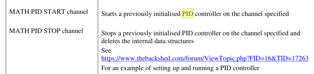

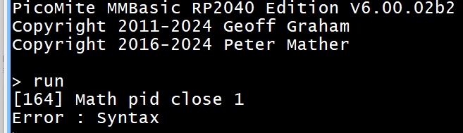

MATH PID CLOSE gives a syntax error - I wonder why? Perhaps the manual will help (page 128)

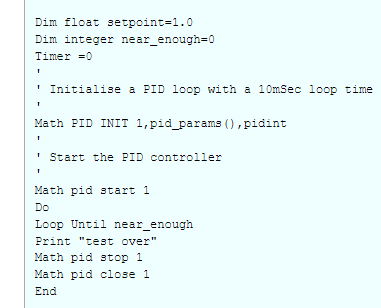

  matherp said  MATH PID CLOSE gives a syntax error - I wonder why? Perhaps the manual will help (page 128)
So it was a thing and now it's not?
This has been running fine (without REMs on older firmware):
I got it from the original example:
Just tested with the REMs and works great
The manual points to the original example which includes MATH PID CLOSE
Edited 2025-01-23 11:10 by PhenixRising

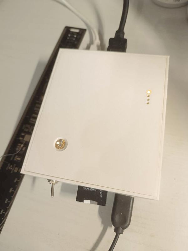

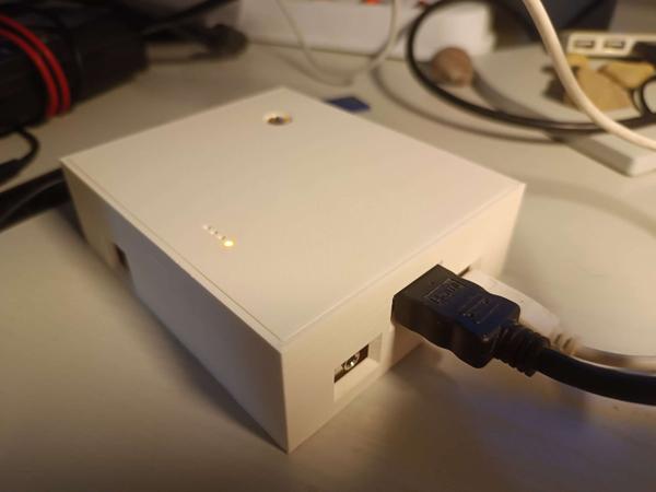

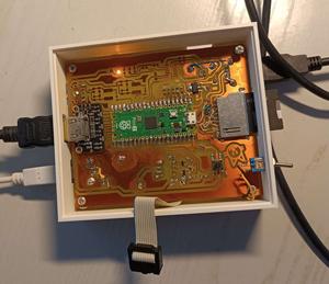

setup --> PICO2 RP2350A , HDMI, USB
For some reason, there is no picture after flashing with PicoMiteHDMIUSBV6.00.02b2.uf2
Nuked, flashed, re-nuked, re-flashed several times, re-downloaded archive - no picture.
Flashing back 2024-12-30_183756_PicoMiteRP2350V6.00.01 --> PicoMiteHDMIUSBV6.00.01.uf2 and everything again works OK.
Not a first time I am flashing firmwares.
But I am lost this time.
(Was highly interested to test I2S sound)
My MMBasic 'sand box'

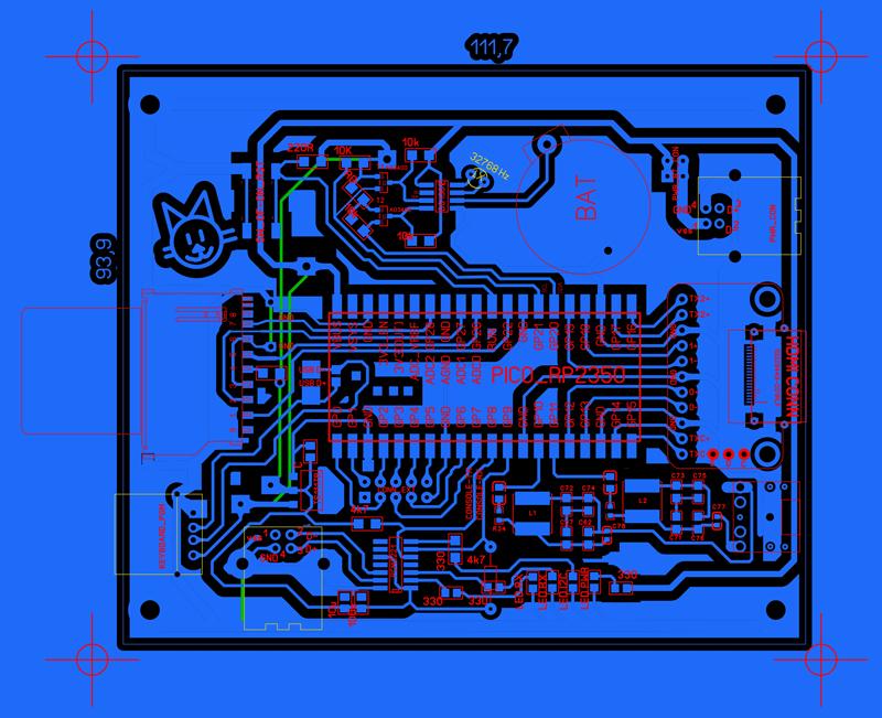

Posted: 10:52am 24 Jan 2025
It might be something with my HW then (hand made PCB, simplified. With unpopulated MCP2221A, adafruit HDMI adapter, cheap but acceptable DS1307 ).
Tried FW you just uploaded - no picture. Tried different monitor - no joy.
Repeatedely flashed to official PicoMiteHDMIUSBV6.00.01 and picture comes back imediately.
For RP2350A I shoud use this file, yes ? -- > PicoMiteHDMIUSBV6.00.02b2.uf2
It might be interestig for You, what people are making: my home made toy :)
