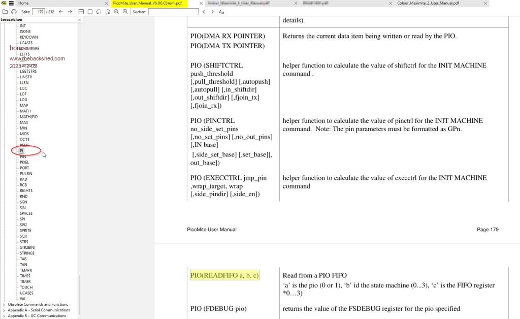

I have questions about the fifth option ‘completioninterrupt’
in the command: PIO dma tx
Could this be buggy? Because it disrupts the serial transmission when I want to use it. So the level then goes back to 0?
I actually wanted to know when the string had been sent so that I could send another one and not send the next one while the previous one was still being sent.
> option list
WebMite MMBasic RP2040 Edition V6.01.00RC21
OPTION SYSTEM SPI GP2,GP3,GP4
OPTION COLOURCODE ON
OPTION CPUSPEED (KHz) 200000
OPTION SDCARD GP5
AND
I can't get the command on page 200 of the manual to work. Where and when do I need to use this command?
This sub in parameter 4 is never called?
Similar for TX interrupt in which case MMBasic gets an interrupt when data is needed for the TX FIFO.

  homa said  Command PIO, Page 139 ff
Appendix F, Page 196 ff
Am I overlooking something? What exactly do you mean? I find the description very brief in some places.
Unfortunately, the search for PIO also finds GPIO.
You have found the PIO command.
Now you need to look for the POI FUNCTION.
Missing in the index but on page 179-180 in the V6.0.3 manual
Search for PIO(DMA RX POINTER)
Posts: 6195
Posted: 08:27am 08 Dec 2025
My manual may be A4 size formatted. Then it is on pages 180/181.
homa
Joined: 05/11/2021
Posts: 723
Posted: 11:19pm 08 Dec 2025
Apologies for the delay, but everyday life calls.
I found it, but I'm not sure if it's the latest manual.
Note: PI is faulty.
I'll test it.
Matthias
Posts: 3416
Posted: 11:26pm 08 Dec 2025
  Quote  Note: PI is faulty.
  Functions said  PI Returns the value of pi.
> ? PI
3.141592654
But PIO is simply missing from the index.
Edited 2025-12-09 09:31 by phil99
homa
Joined: 05/11/2021
Posts: 723
Posted: 08:39am 09 Dec 2025
I am familiar with PI; it was just to show that PIO is missing here.
