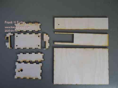

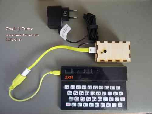

My keyboard and my emulator now have a case:
I have noticed two things about the emulator so far:
- In the file selection menu, it is difficult to select the correct file, as the next line is often skipped even with a short keystroke.
- I have tried a few programs ( https://github.com/tomwhite/zx81-not-only-30-programs ). Despite RESET (Shift+Shift+1), I often cannot load any other programs. The emulator just won't do it anymore. Only when I perform a hard reset with the button does it work again.
