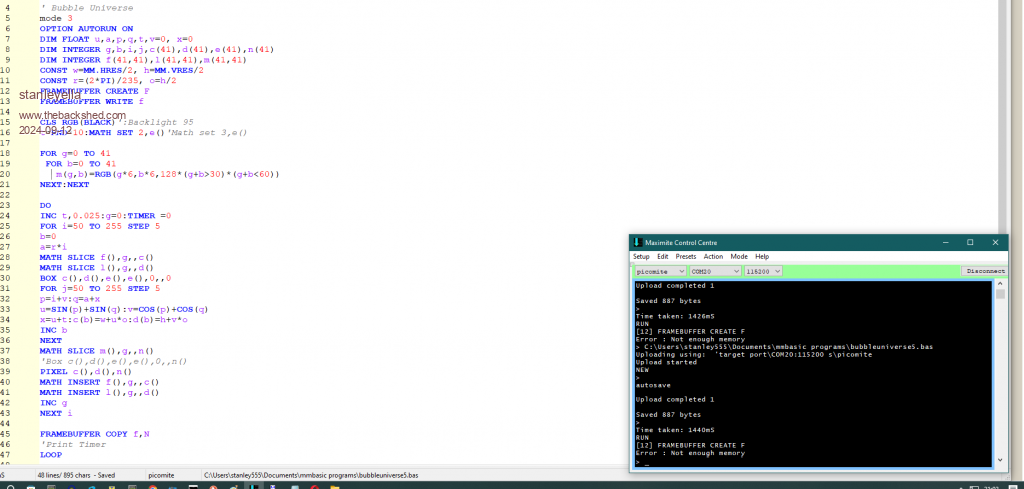

Posted: 09:06pm 11 Sep 2024
' Bubble Universe
mode 3
option autorun on
Dim Float u,a,p,q,t,v=0, x=0
Dim Integer g,b,i,j,c(41),d(41),e(41),n(41)
Dim Integer f(41,41),l(41,41),m(41,41)
Const w=MM.HRes/2, h=MM.VRes/2
Const r=(2*Pi)/235, o=h/2
FRAMEBUFFER CREATE F
FRAMEBUFFER WRITE f
CLS RGB(black)':Backlight 95
t=Rnd*10:math set 2,e()'Math set 3,e()
For g=0 to 41
for b=0 to 41
  m(g,b)=rgb(g*6,b*6,128*(g+b>30)*(g+b<60))
Next:Next
Inc t,0.025:g=0:Timer =0
For i=50 To 255 Step 5
b=0
a=r*i
Math Slice f(),g,,c()
Math Slice l(),g,,d()
Box c(),d(),e(),e(),0,,0
For j=50 To 255 Step 5
p=i+v:q=a+x
u=Sin(p)+Sin(q):v=Cos(p)+Cos(q)
x=u+t:c(b)=w+u*o:d(b)=h+v*o
Inc b
Next
Math Slice m(),g,,n()
'Box c(),d(),e(),e(),0,,n()
pixel c(),d(),n()
Math Insert f(),g,,c()
Math Insert l(),g,,d()
Inc g
Next i
FRAMEBUFFER COPY f,N
'Print Timer
RUN
[12] FRAMEBUFFER CREATE F
Error : Not enough memory
more pico2 stuff that worked 2040. stan?
Posts: 9245
Posted: 07:03am 12 Sep 2024
Don't create a framebuffer in Mode 3 seems to be the answer. At least, not unless your program takes little RAM, so no big arrays.
