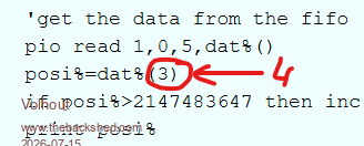

OK, I'm now running 6.02.01 and I'm seeing something but the count doesn't make sense (yet).
I guess I don't understand that GP0 and GP1 are PIO inputs but the test code is addressing them as outputs

Posted: 11:44am 15 Jul 2026
Bit of a problem with the FIFO or something.
The actual pulsing input stops but the real final count value is not in dat%().
It only shows the right value when input activity resumes.
For example, in my case, I am reading "81" (varies) but the value is at correct "0" somewhere in the PIO code.
I remember having a similar pipeline issue with the quadrature decode but because the motor was always alive and closed loop, the true value eventually shows up.

Posts: 6195
Posted: 11:49am 15 Jul 2026
Phenix,
Maybe this helps:
