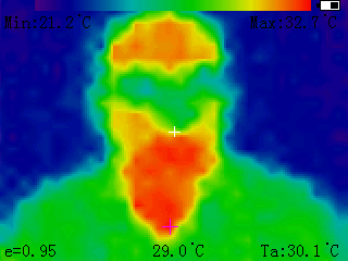

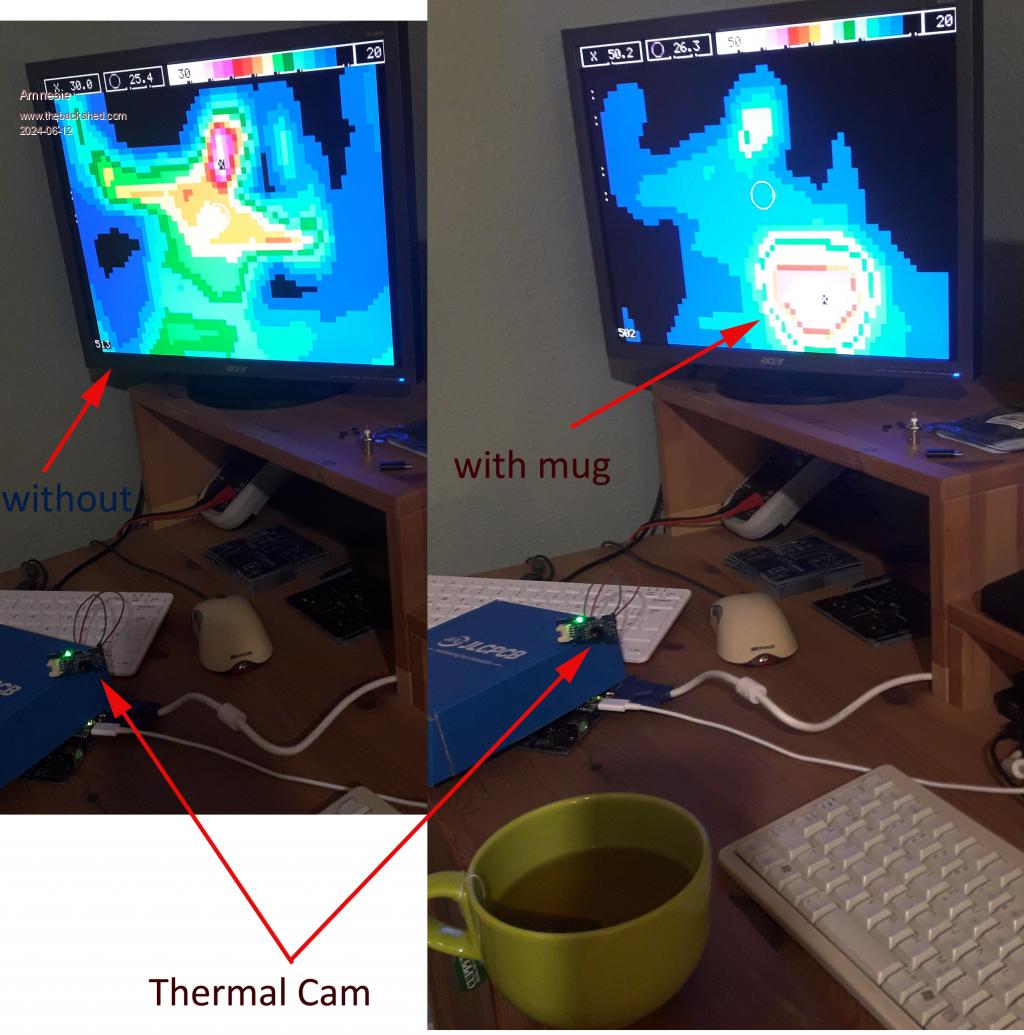

Hi all,
program works great, no problems so far! See some comparision with a hot mug of tea and without just waving into the thermal camera.
Images from the latest software "MLX90641_dev_20".
I think there are MANY applications for this, monitoring events etc.
P.S.: I have the 110 degree view version of the camera module.

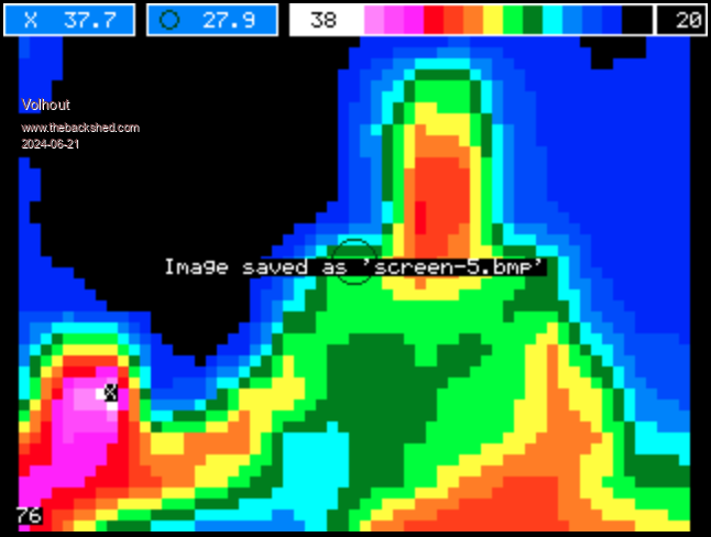

This is the first beta for Game*Mite.
The MLX90641 camera connects to the Game*Mite expansion connector X1, similar as a 1970's photo flash on top of a camera. I2C on GP26/GP27.
The program auto configures for the Game*Mite.
User interface:
- START exits the program (same as Windows....hihi) and return to Game*Mite menu.
- B starts and stops logging
- A save a screenshot
The data is stored preferably on SD card in B:/TCdata, but in absence on A:/TCdata
The program has a configuration for "selfie mode" (camera facing operator) or "camera mode".
MLX90641_gm_23.zip

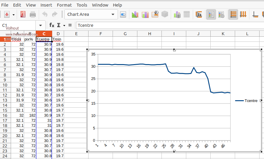

Log data from the CSV file in Libre Office Calc (similar MS Excel)
Screenshot from the camera in selfie mode (with a hot tea).

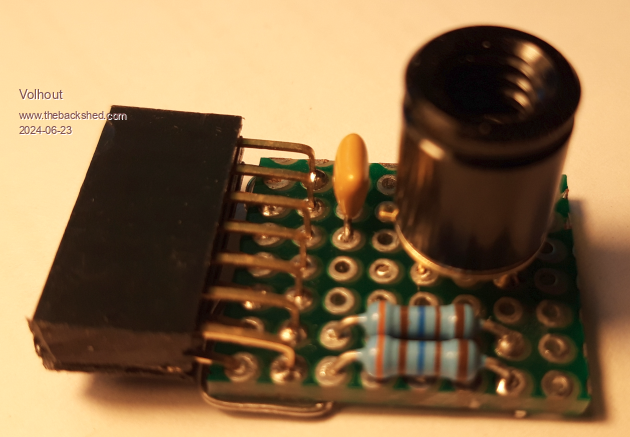

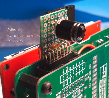

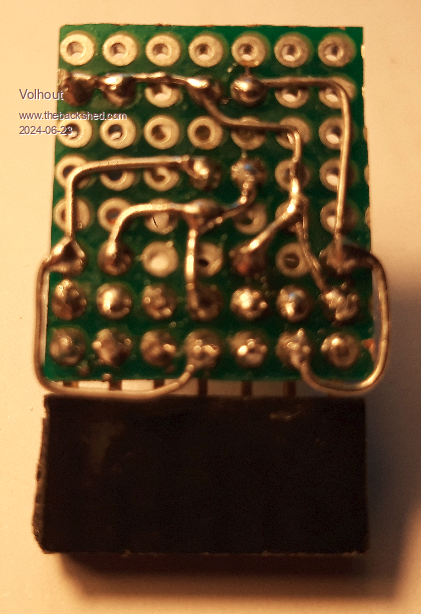

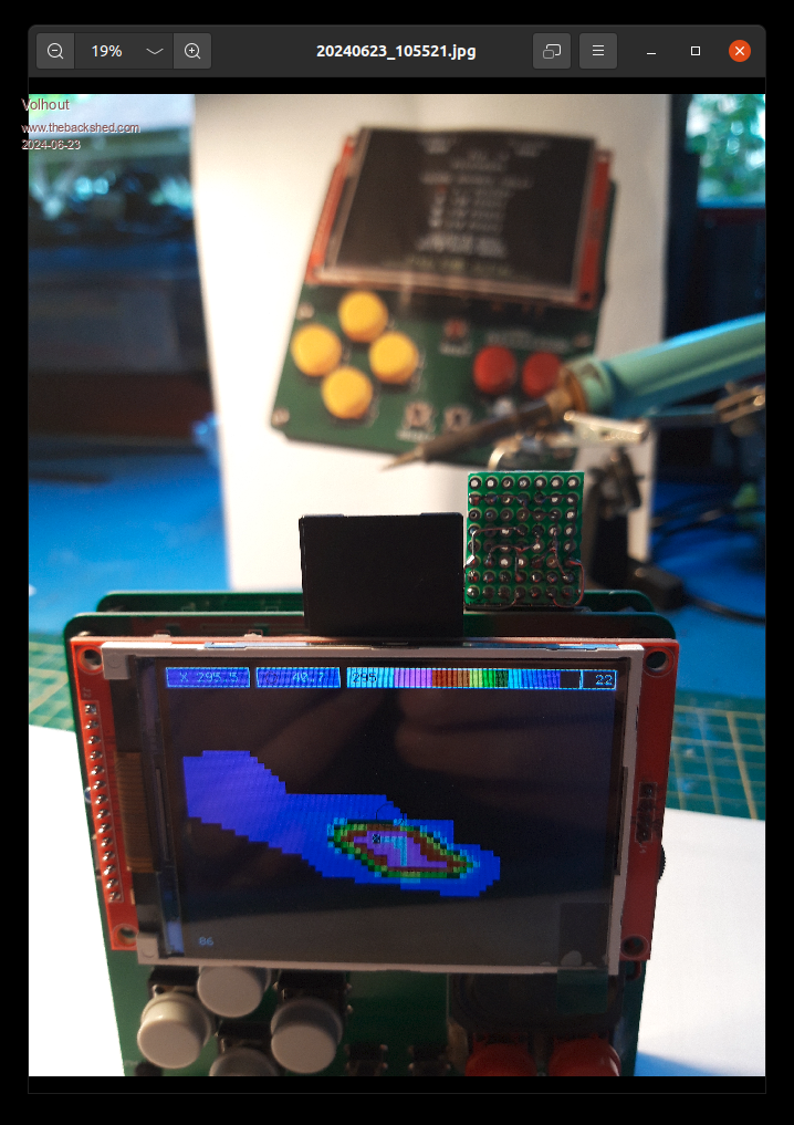

Hi Tom,
Some pictures of the camera and Game*Mite.
Camera on a piece of experiment PCB
Wiring of the PCB
Camera plugged into the expansion socket of the Game*Mite
Camera in action, measuring the temperature of a soldering iron. Around 310 degrees (leaded solder, for unleaded solder you need 360 degrees).
If you want the camera module to show it at your local computer club, I can send it to you. Or build you a copy.
P.S. I see in the action shot, that there are vertical lines in the LCD. These where NOT in the picture I uploaded. It must be some artefact of the scaler on the forum.
P.P.S. I see by the shape of the soldering iron that the camera is in selfie mode. Changed it in the code, but forgot to save the camera mode.
Edited 2024-06-23 19:21 by Volhout
