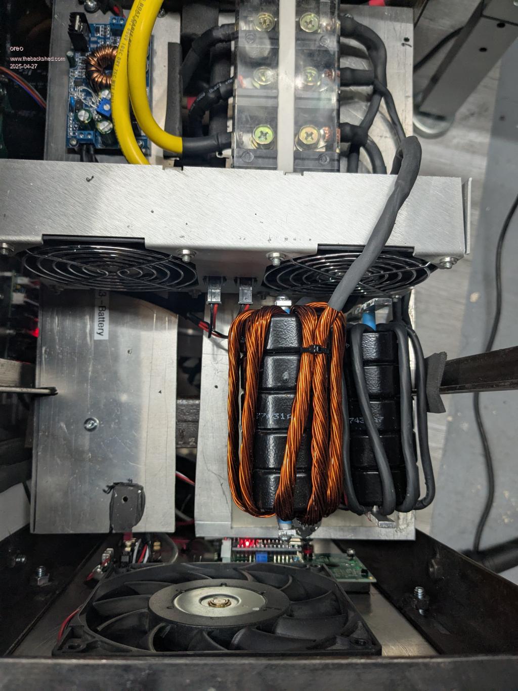

I was hoping to get an idea of what the electronics is capable of, and then setting my current in a similar fashion.  I guess I will take it one step at a time.
I did remove a turn from each inductor, but didn't notice any real change in my shortish period of testing.  One thing I did notice, was that the current draw at idle can change when the noise oscillates up and down in amplitude.  At one point, with the noise at maximum, the unit was drawing 21 watts, and after it cycled down to be quiet it was back to 17.5 watts.  This is not always the case though as sometimes the noise ramps up and I don't see a significant change in current/power.
After doing the testing, I did install the 34uH choke made from the Amorphous cores.
I glued the 4 cores together and filled the air gaps using silicon.  Unfortunately it was low strength silicone but it was all I had on hand.  I have not noticed any noise being generated by the core, but need to do some more testing.  Lots of room on these inductors for wire!

I have never glued the cores together, just wrapped a layer of tape around the stacked cores, they have never made a noise, they run cold, only cable heating can warm them, and that is minimal in my inverter.
I have posted before about a slight noise, like a 1Hz or slower cycling hum that can only be heard at Idle. The Idle current can be seen rising and falling a small amount as this 1Hz "wave" slowly crawls through the Toroid, usually I need to put my ear right next to the toroid to hear it and I've noticed it on most of my builds.
However once the Toriods were in the cabinet it was inaudible, especially since I have a very small AC load on my Inverters that is always on.
Wiseguys single board design is capable of running at 8kW for some time, the limit is more possible PCB bus heating and DC and Toroid connection heat, I had no air flow over the power board when I did that test, and the single Inverter could handle 600A Peak DC input of Surge startup current.
The unknowns are FETS and the higher Voltages that you use, you will have lower current and possibly less heat in the high current Connections, but Peak power may still be less depending on the FETS at higher voltages.

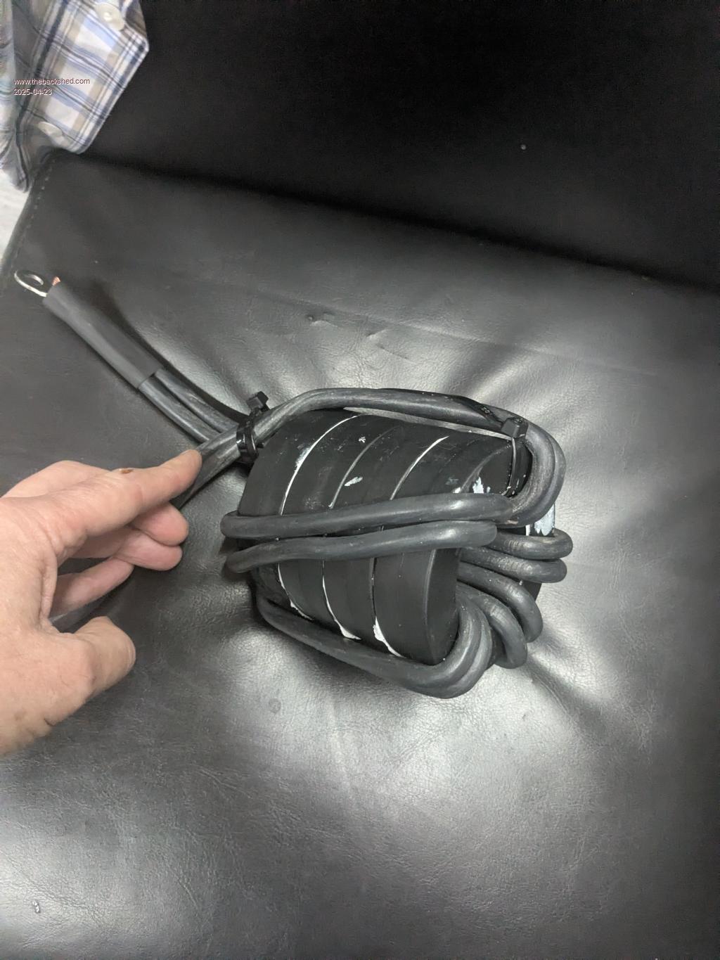

  oreo said   Need to figure out what I am doing on the series chokes.  I did build up a gapped core, which I need to test to hear how much noise it makes.
I meant to comment on this a few days ago, not sure if you are referring to an iron core or a Ferrite core. If it was Ferrite I would strongly suggest that is not the right way to go. Gapped Ferrite will still saturate with a very sharp knee from my experiments. They also have a lot of audible noise which is difficult to suppress.  End result is in an overload event they can detonate FETs with little warning. The sendust/powdered iron type cores are very forgiving and have a really soft saturation behaviour. I started advocating for them in ~ 2019, after some early experiments with various materials and is all I use now.
Dex tried using sendust Ecores - my bad suggestion - they did not saturate but were difficult to wind and their noise emission was unacceptable and could not be muted effectively, then he went to ring cores, problem solved.
Cheers Mike

Thanks for the update and the further build details KeepIS!
Wiseguy, the choke I am testing is not ferrite, but amorphous nanocrystalline like this .  A gapped choke using this core still saturates pretty hard, maintaining 34uH up to 160amps, and then kneeing down quickly finishing at about 5uH at 350 amps.  I am not seeing any audible noise issues with this choke so far, but have only tested up to 4kw inverter power so far. It is unlikely that I would be relying on this core on it's own.

Assuming you currently only have one choke, I wonder if splitting the choke into 2 (one on each leg and each with 1/2 inductance) would help?  I believe that's what KeepIS did.
Interesting.  What's the main reason you chose amorphous nanocrystalline over Sendust cores?

Actually I am using 2 sets of cores, but only replaced 1 of them with amorphous nanocrystalline.
Just trying different cores I already have.  I purchased the 4 amorphous cores because they were cheap and looked interesting.  Cores
Initially from this same EBAY vendor, I had ordered 20pcs of MS225  sized sendust cores but they shipped MS184  sized sendust cores. They refunded my $, but said they didn't have any of the correct cores in stock
(yet they continue to advertise them for sale, even after I sent them 2 emails asking what was going on).  Anyway the thickest wire I can get onto these cores is #6 awg, which is a little on the thin side.
I did a bunch of testing, and the reality is they should be ok (72v=less current, and I plan on using 2 transformers, so will be using 2 sets of 2 chokes).  I mounted a couple of extra fans beside them to keep them cool(ish).
One core was wound with 6awg wire covered with heatshrink, while the other uses magnet wire with the equivalent of 6awg.
If you're looking for cores, I would try ordering the larger size (Kool Mu=Sendust) from this same vendor.  If they ship you the wrong one you can request a refund, otherwise you may get the desired size at a good price!

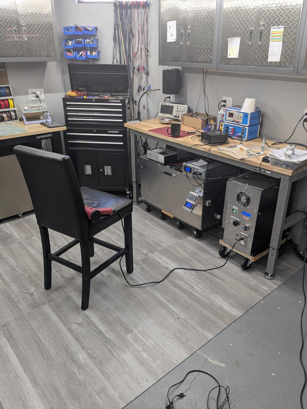

I now have the inverter cabinet sealed up and the noise is less noticeable.
I am surprised with how quickly the transformer heats up, when you have a decent load on it.
With about 5kw out, the fans appear to hold the transformer temp steady at about 56C.
The batteries don't last a long time with 5kw out though.
Next step is to complete the second transformer and inductors, but no big rush for this.
At least I have my work space back.
Greg

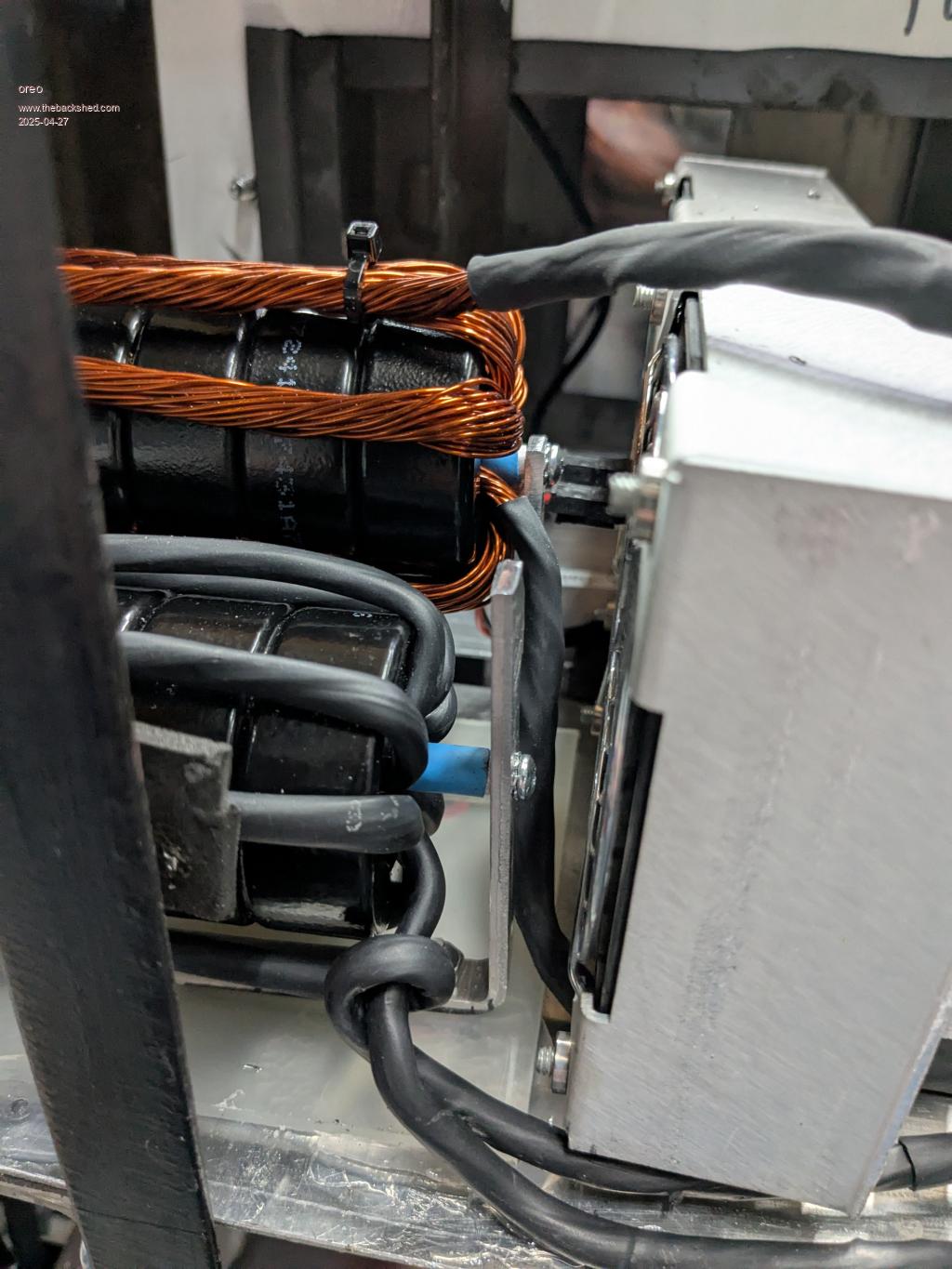

2 points, how did you mount the mosfets? I'm trying to have a good clearence between bolts and pcb itself, I'm using some standard nylon isolation bushes, they just fit between the pcb and the bolt. The M3 bolts are connected with the heatsink and a short between the positive and negative rail on the pcb is not that difficult to make I noticed.
Second point of interest is the way you fixed your inductors, make sure you don't make a short winding, it looks like a short to me at the moment, so you are bypassing your inductance, I could be wrong if the mounting rod/bolt is not going all the way through your inductor or is interrupted elsewhere.
For the rest I really like your build, looks verry neat and professional.

Good pickup by nickskethisniks, if that is indeed a full metal rod through the center of the Choke then the metal bracket at each end completes a full shorted turn ?

  nickskethisniks said  2 points, how did you mount the mosfets? I'm trying to have a good clearence between bolts and pcb itself, I'm using some standard nylon isolation bushes, they just fit between the pcb and the bolt. The M3 bolts are connected with the heatsink and a short between the positive and negative rail on the pcb is not that difficult to make I noticed.
Hi
Point 1 -I am using these  shoulder washers.  They fit entirely though the pcb and fully isolate the screw from the pcb (I had to drill out the pcb slightly to get them to fit though)  Does that answer your question?
Point 2 -If you look closely at the pictures, the core mounting brackets are on plastic (nylon).  This isolates them.  Now actually I initially missed this and had them mounted to the aluminum chassis which resulted in them being shorted out.  My standby current was .45amps, which made me realize my mistake.
