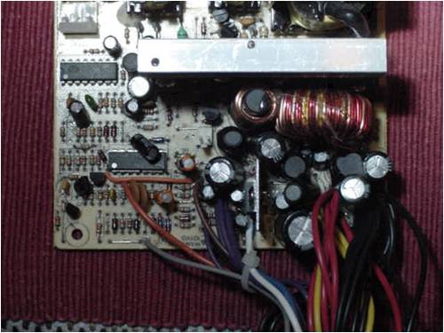

Here is the complete ATX before being "interviewed"..

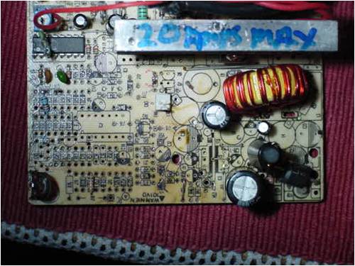

And this is what that ATX supply looks like when you remove some one hundred and 5 components that you don't need.
As you can see, it requires very few components around the 494 to make a perfectly stable voltage and current controlled device.
It is better than the AT in that the supply voltage is supplied from the aux flyback supply, and so can go to very low voltage be fully controlled at max current.
This one is now set to 20A max, can be shorted and still push 20A through the meter.

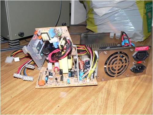

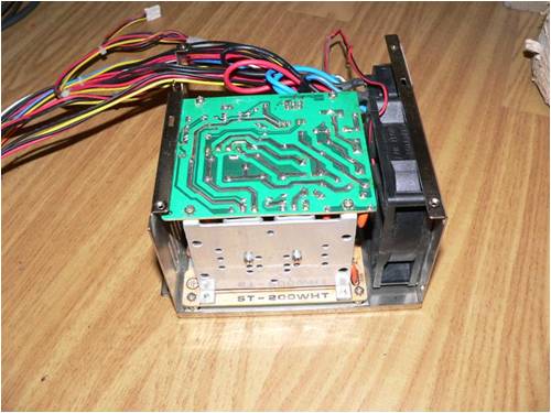

In the mean time, I've opened the other AT box for surgery. This one has the "IR3M02" ,sharp equivalent of the tl494. It also has the second error amp disabled, so it seems like a good candinate for the sensing wire current limit-mod. This one is quite odd also:
The cover removed. Everything is boxed between the PCB's and heatsinks.
The workings removed from the case and top PCB opened. The heatsinks (= the 2 aluminum plates) seem rather puny. Edited by Janne 2009-05-10

Use a scope while it is in this state, and you will see the wave train which is doing this..... this is how it bootstraps.
In normal startup, the 494 sees this voltage being generated in the secondaries, and starts to wake up. It then drives the proper switching pulses into the driver, and swamps the little feedback wave train and we run normally.... until an overload arrives and sends the 494 into stall mode again, requiring a complete power down to recover... thats why we need complete power down, otherwise the bootstrap pulses will keep it alive enough to keep the 494 turned off.
In an ATX, a simple uncontrolled flyback (on the HV side) provides approx 30v onto Vcc of the 494, and it is alive. Other control voltages keep it sleeping until called upon, and it still uses this uncontrolled supply for it's vcc.
In AT's with a resistive bootstrap, it can only be that your looking at a single switch flyback, or dual switch halfbridge... but the pwn chip will be on the HV side of the board, and will require opto isolators to ascertain what the secondaries are doing.....for control.
Janne "In one atx schematic I saw the power to tl494 was provided directly from the HV side by a voltage divider circuit, and the workings of that are clear to me..." This must mean the pwm chip is on the HV side....(likely flyback topology) other wise the LV isolation is compromised. So I would be surprised to see the chip on the LV side for that reason.
Dinges "If I'm not mistaken, the bootstrap method (using a resistive voltage divider, powered by the primary voltage), is used in AT supplies, which do not have a secondary (permanently on) power source as the ATX"...... see above.
As for the heat gun... I use a makita heat gun with no nozzles... broad heat indeed. But if you hold the board with something, and face the draft towards the LV half of the board from a few inches away (but the exhaust heat leaving the board at an angle to keep the good bits out of the hot air, localised burning heat is avoided. In a minute or so, the whole solder regime under "inspection" is melted, and a tiny jewelers screwdriver can easily prise off the bent component lead devices, the rest fall out. These boards have oversize holes I have found. and few components need help.
It must work, as I just did it??.. and the board is still fine.
In the case of the board above I did, all components not used in directly powering the 494 from the aux got the chop. A reference voltage is still available from the 494 at a few ma if required.
Will do more with the full wave in a day or so... have a wool shed to dismantle today... muscles are aching from yesterdays effort
Edit
Dinges, I just looked at the circuit you linked too. It seems the third "positive feedback" winding is still in the driver transformer. It may be possible to use a single diode and capacitor to boot the 494 up without the aux circuit on the atx. (boot pulses should still be there... legacy???..Interesting, although the aux is already in place in the atx and provides stability in the low volts region where the AT may fail.
Another advantage with the ATX, is that you can fire up the 494 and disable the b+ to the switchers, and test your control circuits with a lower b+ and watch the pulse width change as you fiddle the inputs(on a scope). (inject your own voltage into the error comparators and see the results without smoking it up. May be a good learning tool.
.........oztules
Edited by oztules 2009-05-14

Well, it looks like they do use the same transformers. A quick unsolder of the driver transformer, and unwrap of the outer sheath.... shows us the 2 turns are there as suspected. If you disconnect the flyback driver and look for the pulse train.... it's not there..... hmmmmm.
A quick check around the driver bits and pieces and we find that there is no base collector resistor. By slapping two 330k resistors from the base to the collector and we find the pulse train strong and clear.
If you look at the circuit you pointed to, you will see C9 and C10. The 330k resistor goes from neg terminal of the caps to their respective collectors.... and we have an AT startup legacy device.
Useless I guess but we now know a little more. However, if you find a dead ATX supply, that has a faulty flyback circuit, you can bypass the flyback stuff, add the resistors and go on to modify it as normal.
.......oztules
Edit: As an aside, I have noticed that if the flyback driver dies, everything in the whole area dies.... all the diodes, half the resistors, the transistor/s... the whole lot... and all hard to get to. There is a lot to be said for having the driver gear on the LV side of the transformer. I don't like HV logic switching for this reason.... when it goes wrong it goes really wrong.Edited by oztules 2009-05-14
