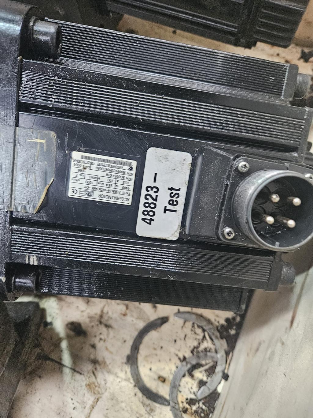

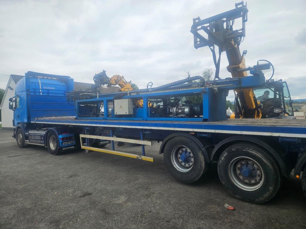

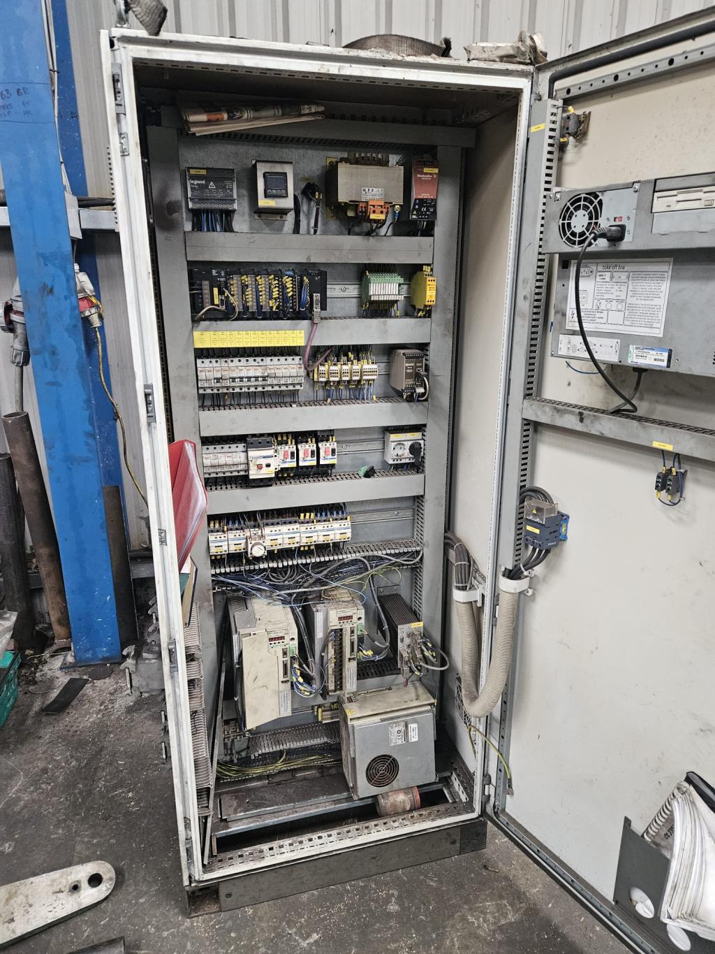

I have a machine on the way, it's gonna be the first all-PicoMite controlled. Yaskawa motors feature 17bit Encoders
A good test for the PIO
PicoMites to replace obsolete OMRON and Rexroth motion controllers plus the PLC
Profibus is also history.
Loaded-up in Ireland, yesterday.
