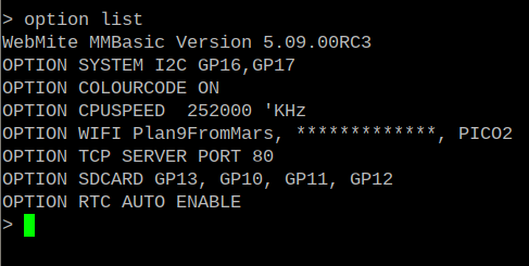

I posted this problem during the 5.09Beta posts for the WebMite and it was suggested that I re download the firmware again. I have been doing this for every update till now RC3 and still have the same problem.

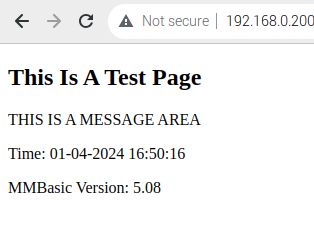

This worked under 5.08;
These are the current options under 5.09RC3;

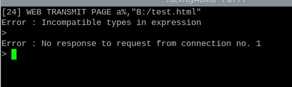

The program error message;
The program code;
Dim buff%(4096/8)
Dim string mystring,mytime,currentversion
currentversion = Str$(MM.Info(version))
mystring = "THIS IS A MESSAGE AREA"
WEB TCP INTERRUPT WebInterrupt
   '<do some processing here>'
   mytime = DateTime$(now)
Sub WebInterrupt
 Local a%, p%, t%, s$
 For a% = 1 To MM.Info(MAX CONNECTIONS)
   WEB TCP READ a%, buff%()
   p% = LInStr(buff%(),"GET")
   t% = LInStr(buff%(),"HTTP")
   If (p% <> 0) And (t% > p%) Then
     WEB TRANSMIT PAGE a%,"B:/test.html"
 Next a%
It is the same code as in the 5.08 manual with the addition of variables.

Posts: 6631
Posted: 06:23am 02 Apr 2024
Hans,
I don't think there is anything wrong with your code.
If you change the / to \ in the filename you don't get the error but no page is sent.
The browser gets a 404 instead of the requested page.
I haven't had a chance to do a full test but there is definitely something astray.
