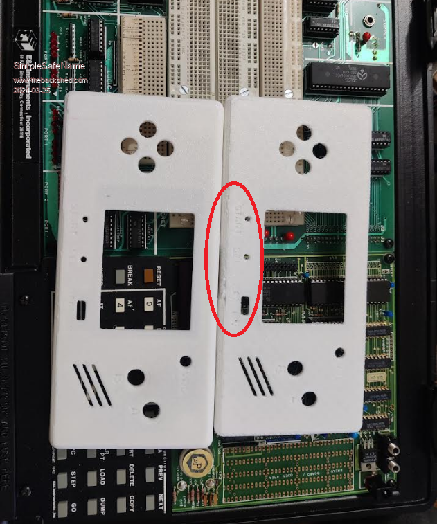

So, I printed it out three times (I'm about to print it a fourth time), and here's a photo of the first two top half of the cases:
Neither one of them came out all that great, and they don't remotely approach the quality of Geoff's case. But they appear to be useable. And each one printed in about an hour, for about 25 cents.
As for my experiences:
So there's something going on with my QIDI X-MAX3. It's putting out crappy prints. I did a bit of maintenance and, meh, I'll have to keep looking for the problem. Specifically it want to print out rough edges as if it were have a Z-banding problem.
The face of it is a bit rough, but I am using my PEI sheet (designed for excellent adhesion of the plastic to the bed), so that is to be expected. That part of the print came out perfect. So good that I can see where I scraped the PEI off of the bed in a few places (oops).
The filament always needs something to lay on.
Due to the curves at the edges, from the front to the sides, you should set the layer height setting to fine.
I had a usable result at 0.12 mm layer height with a .6mm Nozzle (estimated 5 hours printing time)

  Martin H. said
I used 0.12mm on this print (0.12mm is the best that comes "standard" with the slicer), and it took 2 hours. I'm now seeing "defects" in the print which appear to have come from my "repair" of the board.
It looks like my repairs worked, the layer shift appears to have gone away revealing the pattern created by MeshMixer.
The only thing that my fixed board has going for it is that it will play nice with OpenSCAD.
It would be nice if OpenSCAD ignored minor errors since they apparently are the only ones that care. FWIW, the errors in the Thorn gun caused severe printing problems, so sometimes you have no choice.

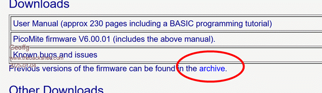

Posts: 3369
Posted: 09:17pm 03 Jan 2025
I try to keep old versions of the firmware (with manuals) available.
They are under the archive link.
