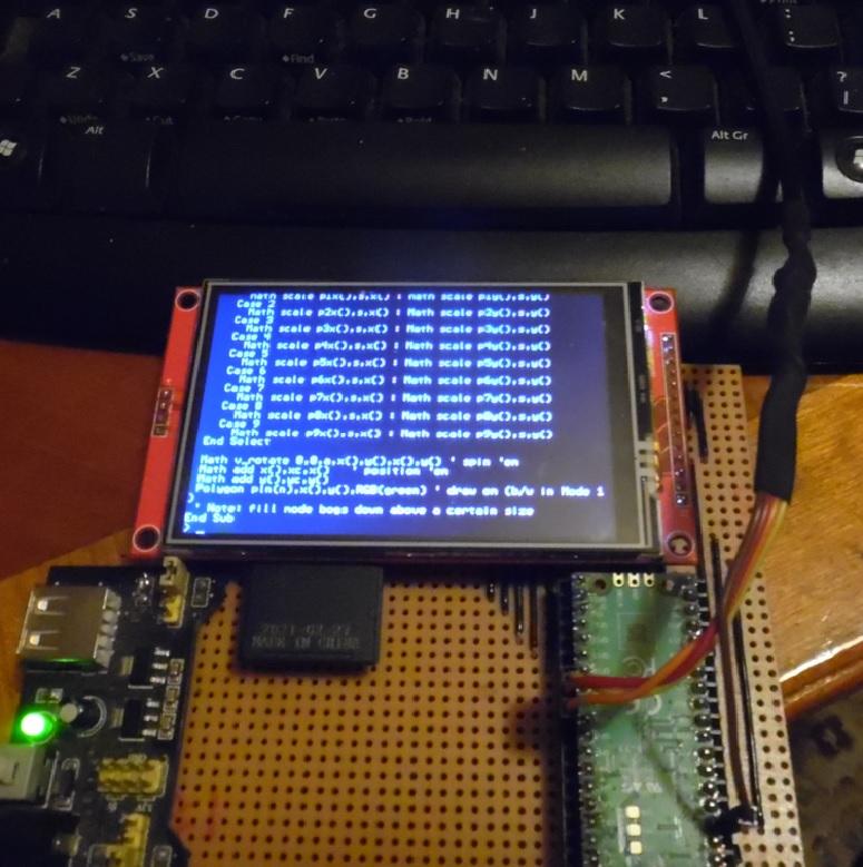

Hi Peter,
One thing I have noticed while testing the new scrolling regime in the editor, I'm still using the original version, not your latest USB version, as I don't have a USB set up at present.
The scrolling rate is dramatically improved with clock speed.
Clock speed 133MHz
Font 7 single line scroll=5.7lps, page scrolling 100lps
Font 8 single line scroll=5.5lps, page scrolling 136lps
Clock speed 252MHz
Font 7 single line scroll=9lps, page scrolling 160lps
Font 8 single line scroll=8lps, page scrolling 200lps
Clock speed 376MHz
Font 7 single line scroll=10.7lps, page scrolling 230lps
Font 8 single line scroll=10.5lps, page scrolling 280lps
lps=lines updated per second.
This looks to be amazingly good on a 240x320 ILI9341 screen, font 8 allows 38x81 characters in the editor, which makes it very usable, even font 7 gives 28x54 characters. I'll wait to see how it looks on a 4" 320x480 screen, but I'm very hopeful. :-)
Thanks for all your hard work on this improvement.
Regards, Kevin.

Hi Peter,
Thanks, that is mainly working on a ILI9481IPS 320x480, Page up/down fine, but single line scrolling or the "LIST" command causes a "Error : Display not configured" when it gets to the bottom of the screen, don't know about "FILES" I haven't got the SD set up on this screen, don't worry about any further updates for now.
Using Font 7 the Editor gives 38x81 characters quite usable.
Using Font 8 the Editor gives 51x121 characters, very small on a 3.5"
Testing this screen, which I believe you said was particularly slow, which shows itself in the fact that the update speed doesn't dramatically improve this time.
Clock speed 133MHz
Font 7 page scrolling 61lps
Font 8 page scrolling 85lps
Clock speed 376MHz
Font 7 page scrolling 82lps
Font 8 page scrolling 120lps
Still reasonably useable in the editor, hopefully my new 9481 4" will make the font 8 a bit larger and be a bit faster than the IPS? but Font 7 at 38x81 is still better than I could ever have hoped for. :-)
Regards, Kevin.

Posted: 01:19pm 18 Mar 2024
I have now found I have a ILI9481 320x480 not IPS.
The speed is much better than the 9481IPS.
Clock speed 133MHz
Font 7 single line scroll=3.1lps, page scrolling 90lps
Font 8 single line scroll=3.0lps, page scrolling 100lps
Clock speed 376MHz
Font 7 single line scroll=4.8lps, page scrolling 150lps
Font 8 single line scroll=4.5lps, page scrolling 200lps
Much more like the ILI9341 in speed, bearing in mind the 9481 is twice the number of pixels.
So for speed at this resolution, it looks like this is the best option, otherwise use a ILI9341 at 240x320, it's a shame there does not appear to be a 9481 that is any larger than 3.5"
Regards, Kevin.
