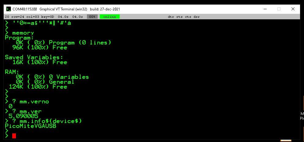

Posted: 10:04pm 03 Mar 2024
WORKING! - YAY!!!!!
I noted that LED1 blinks once quickly, then settles into the usual heartbeat blink.
Is that by design, so you know it is the VGAUSB version of the FW?
I expect it probably is, and is a good way to know that you have that version "Inside".

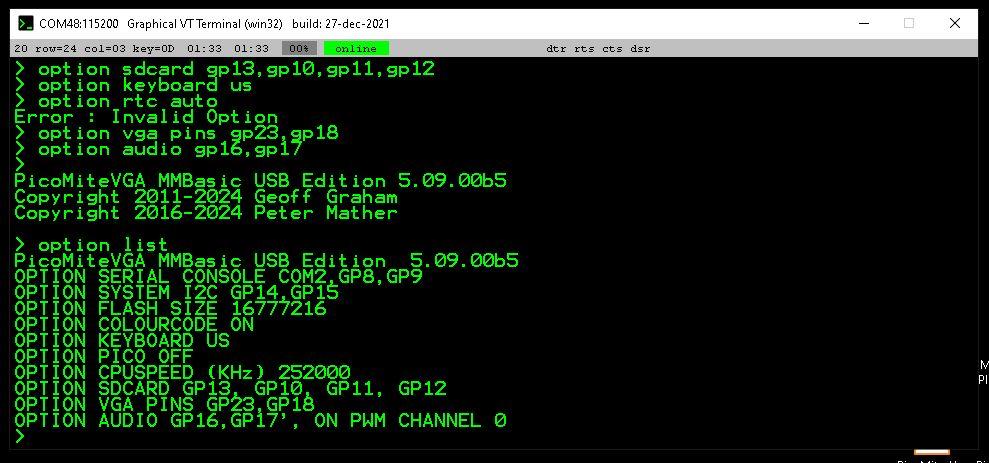

Posted: 04:47am 04 Mar 2024
OPTION RTC AUTO throws an error: (invalid option)
This may not have been added to the beta yet - yes/no?

Posted: 05:13am 04 Mar 2024
Looking at the manual it might need ENABLE or DISABLE as well.
Looking at the code it will say "Invalid Option" if one is not specified.
Try
OPTION RTC AUTO ENABLE
or
OPTION RTC AUTO DISABLE

Posts: 12071
Posted: 08:15am 04 Mar 2024
Its an omission on the silkscreen. As disco4now says add "enable". Corrected on the latest gerbers
