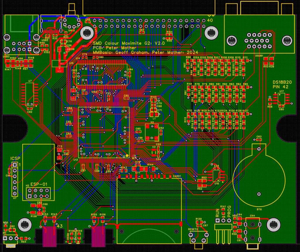

It isn't a crystal but a crystal oscillator package which is what fixed the issue for the original CMM2. The CMM2 G2 is a 4-layer board with a complete ground plane as the second layer - always has been - there is no way it could be routed with two layers.
Noise could conceivably affect the 32KHz crystal but that is supplemented with the DS3231 RTC so the time is reset regularly.
Unfortunately the way the STM32H7IIT6 pinouts works means that it is inevitable that you ware going to have wires all over the place
Current state of the layout without the GND and VCC planes and about 6 wires left to route. As you can see, there is very little near the crystal oscillator or 32KHz crystal.
Red - top, blue - botttom, green - VCC layer. No routing on the GND layer
Edited 2024-02-26 18:31 by matherp

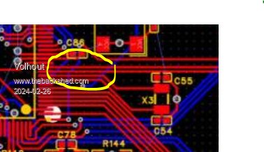

Hi Peter,
The crystal oscillator will take care of the jitter. Perfect.
For the 32kHz oscillator, maybe move the HSYNC and VSYNC away from the oscillator pins. In my company we have to be very strict in this sort of circuits, since we have been hit by problems before. I may be to conservative.
It is a general rule, that if you have 3x clearence over 1x copper trace width, the coupling between signals is minimal versus used board area. So a 10 mil trace would require 30 mil isolation from nearby signal traces. You could apply that (as good as you can) for the 32kHz oscillator. But also (where possible) between HSYNC and VSYNC. It may not be possible everywhere, but especially in larger runs it helps when there is distance between them for the majority of the run. Signals that are especially affected are "higher impedance" signals, such as crystal oscillators, but also I2C...
Question: what is the H5 header for ?
Edited 2024-02-26 19:17 by Volhout
Posts: 12069
Posted: 10:32am 26 Feb 2024
Harm: thanks for the feedback
H5 is the BOOT/RUN select header. Previously to flash a new version you had to open the box to move the header. In this layout you can move the header through the front panel.

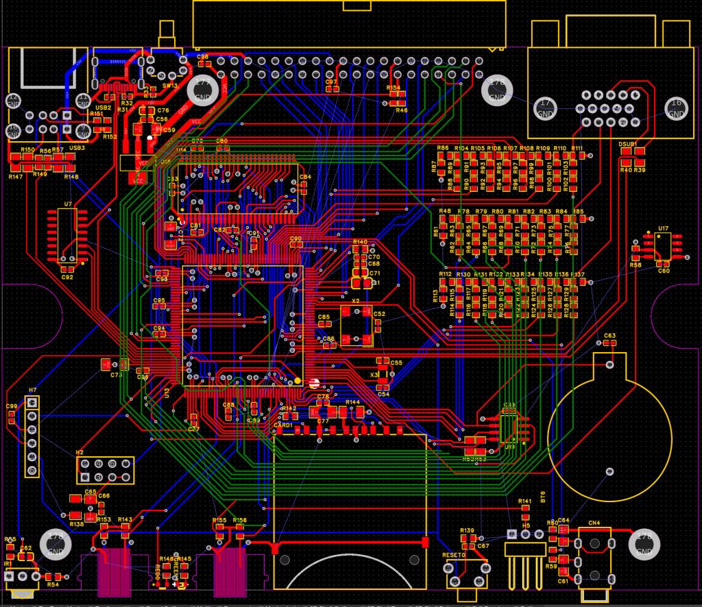

Posted: 11:36am 26 Feb 2024
Here is the "final" layout. I've omitted the GND plane but this sits between the top layer (red) and the VCC plane (green) with the bottom layer (blue) at the bottom (obviously).
The ground plane has no tracks
Edited 2024-02-26 21:38 by matherp
Posts: 6199
Posted: 11:39am 26 Feb 2024
Hi Peter,
Have no idea about U15 (3.3V regulator) dissipation, would it need some copper on the red layer added to the tab ?
Edited 2024-02-26 21:40 by Volhout
Posts: 12069
Posted: 11:48am 26 Feb 2024
Yes: I do this on the original. I just left it off for clarity
