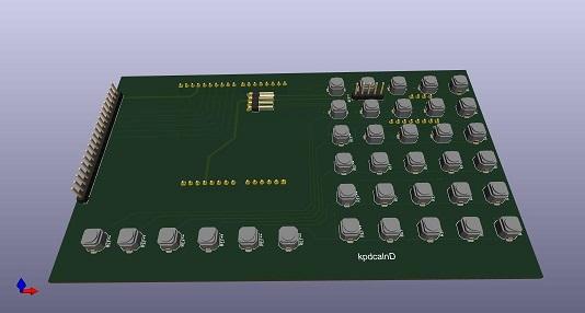

Reworked the pcb to use the silent push buttons.
As before, the tca8414 module plugs in and provides i2c sockets.
The kicad view includes some pins on the front which will be left off in use.
The 6x5 area should be useful separately as a keypad too so I have created a cut-down with just that.  Maybe the 'mites can use a I2C keypad ?

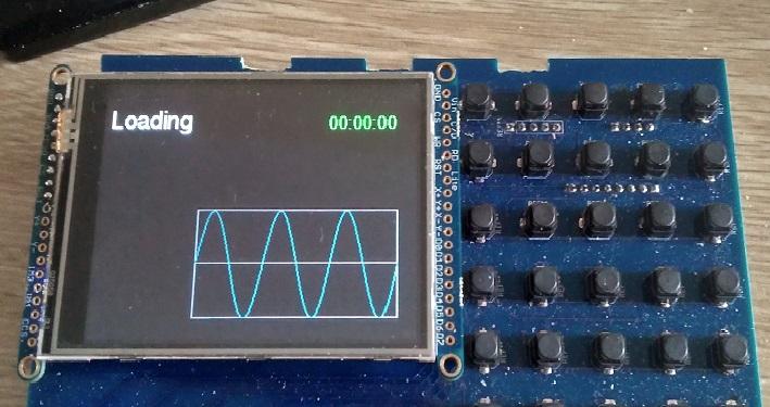

Added a small graph display, just 100x200 pixel but good for a quick optic.
It is fed an array of y value integers scaled 0 to 100, assumes x 0-100 integer inclusive scale wide so 101 values - needs some tweaks yet.
Eg this calculates sin values for three cycles and displays it.

Edit - replaced photo
Edited 2025-03-04 10:16 by zeitfest

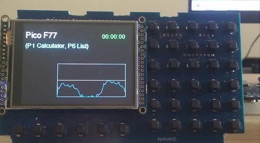

Also added access to the analog-digital converter, just as a basic nicety ( we can't have graphs without measurements now, what in the world rant etc  )
Just using as a keyword in the first instance eg ADC0 gets the value from the A/D measuring on analog pin 0.
Running

The screen result from above shows about one and half cycles of background humm at 50 Hz as present on my thumb so that is the loop repeating at a bit over 3kHz by default.
The A/D can be operated much faster, the loop is not intended for speed,  but it is ok for the time being. I think the A/D is being switched on and off each loop which is not optimal.  OK for a "calcometer" so far
Edited 2025-03-04 18:16 by zeitfest

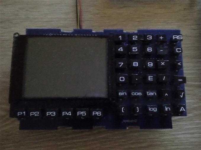

Posted: 02:21pm 01 Apr 2025
Now I realize the quiet push-buttons used are the ones suggested by Franknfurter,
excellent idea thanks !!!
A problem with DIY keys is putting a logo on each. I tried labels/glue/foam/etc but the results were not robust and didn't look very good. However I noticed a photo service shop would print photos onto a "card" which turned out to be laminate.
It has two thin aluminum sheets bonded to a plastic core, the photo is scanned and printed on it, the ink is light-cured and robust.  Very easy to work with and not expensive. So I got the key logos printed onto a "card" and  and stuck them on the keys with bonding adhesive, the keys destruct before the logo can be separated. Needs a suitable case but looks good so far.

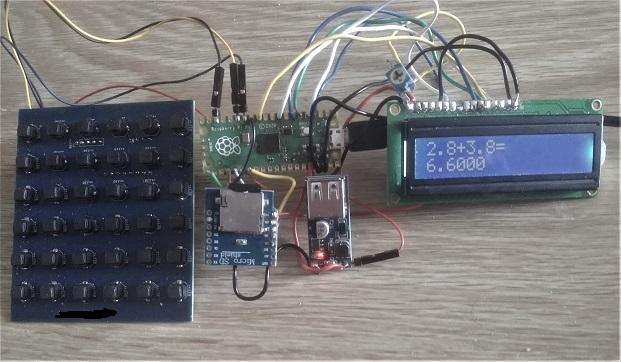

Posted: 10:41am 06 Jul 2025
Tried a version with 16x2 lcd and a 6x6 keypad...works ok so far
(in Salvador Dali air-wired mode  ) but the lcd is a bit
cramped. Less cost though.  I think a bare bones version
with a smaller 6x5 keypad would fit on a 4" pcb.
[showing the pico, sdmicro adapter, keypad and 5v booster with a red led]
ed- changed backlight to 3.3v supply instead of 5v, wire is behind lcd.
replaced photo.
I'll post the keypads if there is interest, they are not complex but might
save some hack work
Edited 2025-07-07 13:19 by zeitfest

Posts: 6197
Posted: 06:30am 08 Jul 2025
Hi Zeitfest,
You mentioned the LCD backlight is now driven from 3V3. In case the whole LCD can work from 3V3 you can remove the 5V convertor. Apply 3V (2 x AAA call) to the Vsys pin of the Pico, and it will generate 3V3, even when the batteries drain to 2V.
