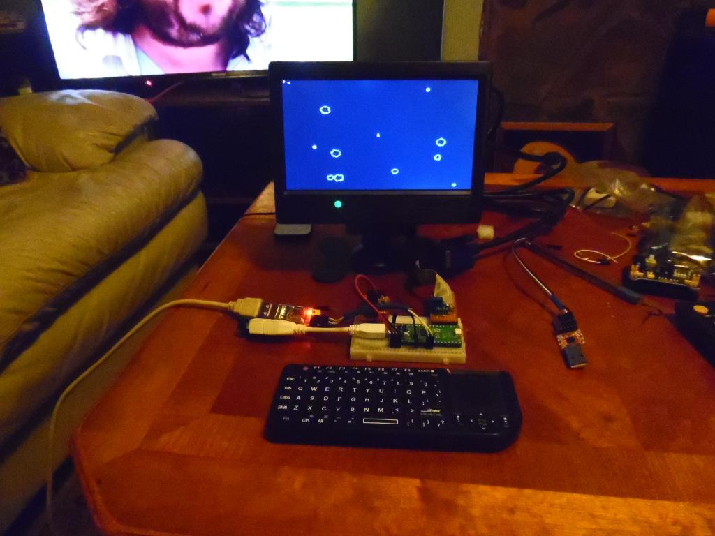

Posted: 06:25pm 15 Feb 2024
Peter sir, sorted teraterm, it was 9600, thank you very much for replying. you have to contend with dim wits like me, thanks for your patience.
Being able to use a usb keyboard means no more full sized keyboards hoggin space and I use a 7" vga/hdmi/avi £12, 5v to 24V display  (sold as car reverse monitor)
I don't know what resources are lost with usb compared to non usb picomite but so far it's been a great option imho.
All coding on win pc with mmedit although can use usb keyboard and it's like a terminal.
I never got into the vga mmbasic as it was on a table with a 14" monitor and full sized keyboard in the corner attatched to another pc and I couldn't watch tv.
This is more compact and doesn't block the tv :)

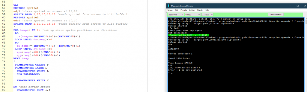

Not sure this error, wrong line number. it did work until this beta but sprites have changed.

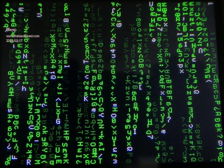

Posted: 05:00pm 16 Feb 2024
This is a copy of my latest Matrix Code Rain display. It's using some of Peters latest stuff like Blit with a LCD, frame buffers etc. so you need 5.09 or greater.
The display is scrolling down at a rate of 4 pixels at a time to improve smoothness.
It should run on any Pico, LCD any size or a VGA, hopefully. I have some relatively large Pauses in the loop, so this is amazingly fast, considering the whole screen is being scrolled every iteration.
Video Here
MMBasic file
matrixcode.zip
Regards, Kevin.

Posted: 09:19pm 16 Feb 2024
  Quote  I attach a simple demo program showing a standard PicoMite (or PicoMiteVGA) using all 64 sprites with full collision detection
I got
RUN
[8] Sprite set transparent 0
Error : Syntax
> option list
PicoMiteVGA MMBasic Version 5.08.00b0
dunno?
